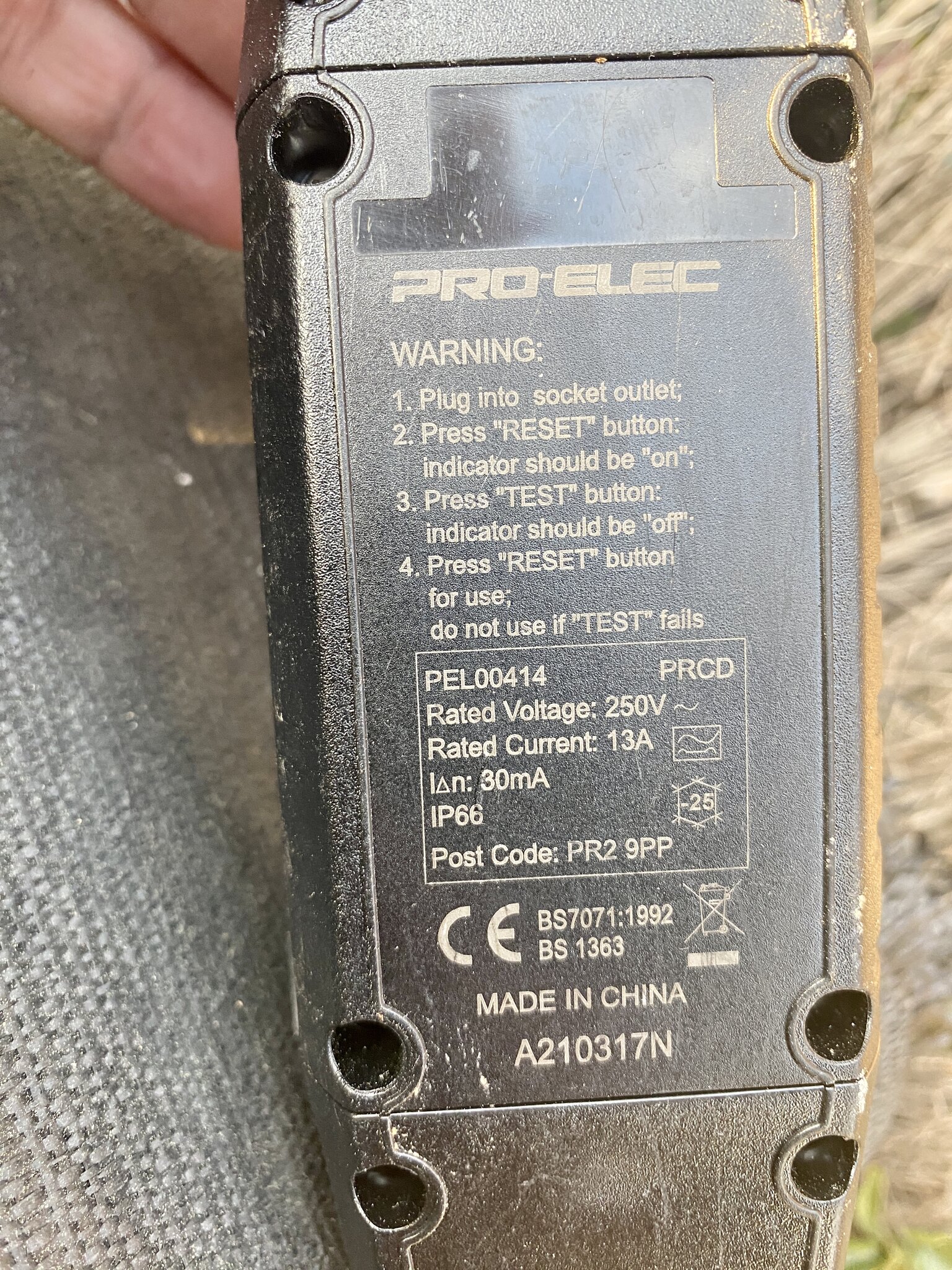

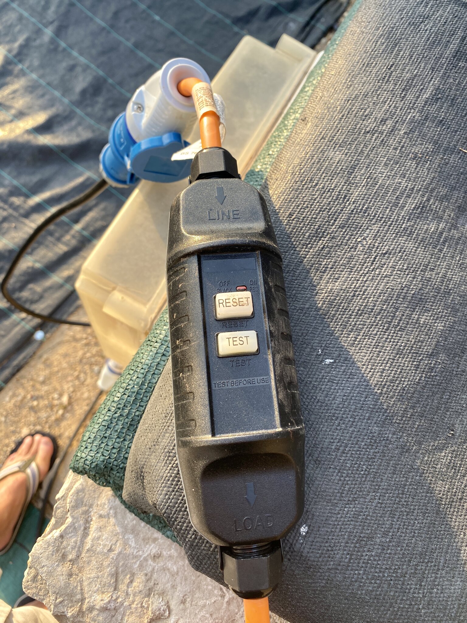

To combat it in future, we have purchased an Inline RCD, waterproof, 13amp max. European Inline RCDs are 16amp. It is fitted to our electric cable at the end nearest the electric supply. If the electric is cut off, then switched on, the unit WILL NOT supply the van with electric UNTIL the reset button is pressed. It cost £20 on Amazon. Please see photos attached
