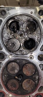

Just coming to this post today. I had a 2.3 engine fail on me last Augustwhile touring England. The van was a 2018 bolero, 24k on the clock. I got an insufficient oil pressure warning then really scary noise. Engine was totally seized. After getting recovered to our local Fiat garage in Scotland I had to go abroad for work. Fiat garage was a nightmare to deal with, they were dealing with my wife over the phone. All they would tell her was it was 'oil starvation' I kept asking how the arrived at this then I asked for engineers report, I didn't get one , I said I'd provide an independent engineer to assess the damage. Their reply was they would not accept 3rd party report as proof. I am a mechanic working offshore in oil exploration and 22 years aircraft engineering experience before that so I asked for a report in technical terms, I never got it. After a huge drawn out process we got our van back in January. with a huge bill. When I was talking to the technician that done all the work he gave me copies of pictures he took, he said he never decided what the fault was all he did was take the pictures and videos and send them to FIAT Italy. Bottom line is #4 injector was found blown and a valve in #4 cylinder snapped. I asked him to explain the pictures and how that pointed to oil starvation. I said to me it looked like the tip of the blown injector entered the cylinder and stopped a valve from fully closing, then the valve was struck repeatedly until it snapped. He said 'well I've never saw that before. Still waiting for explanation from FIAT Italy. Good luck.
