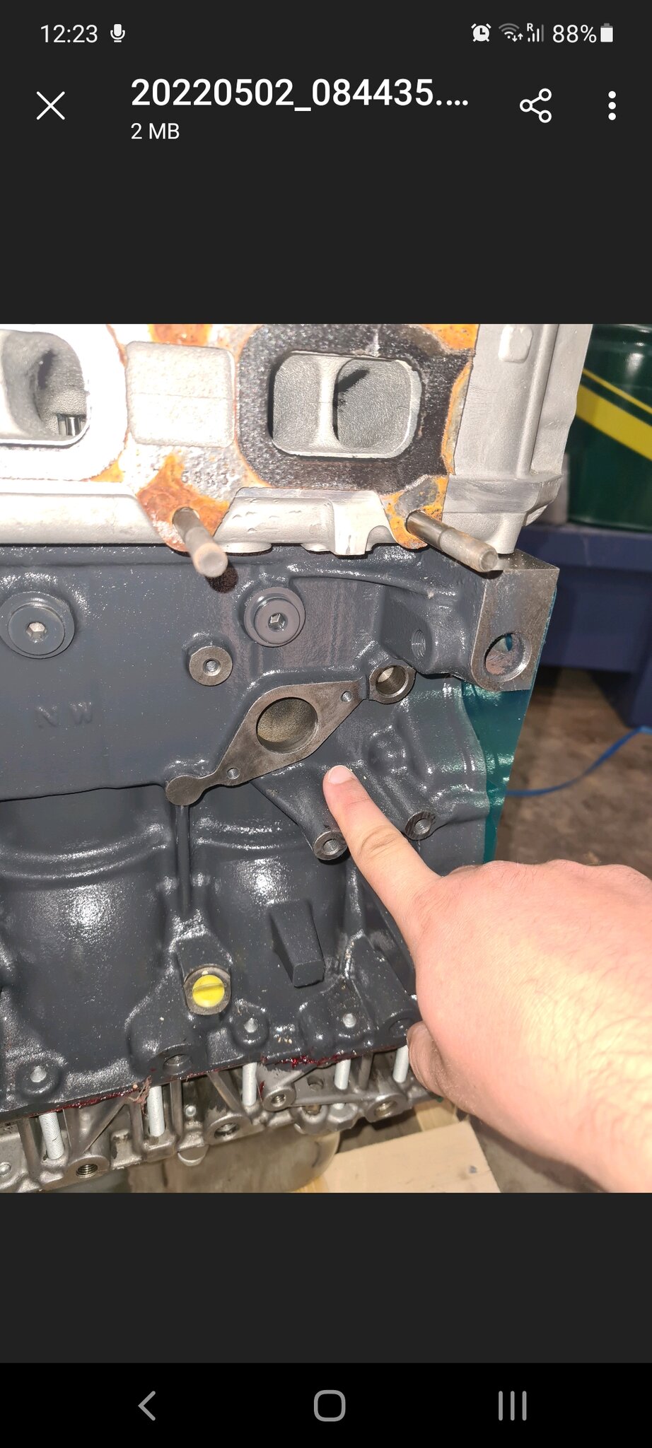

The difference between the old and new (wrong) engine are shown in these two photos.
My thinking is why not blank off the hole and get on with it. Or can anyone who is clued up on these engines kindly enlighten me otherwise?
