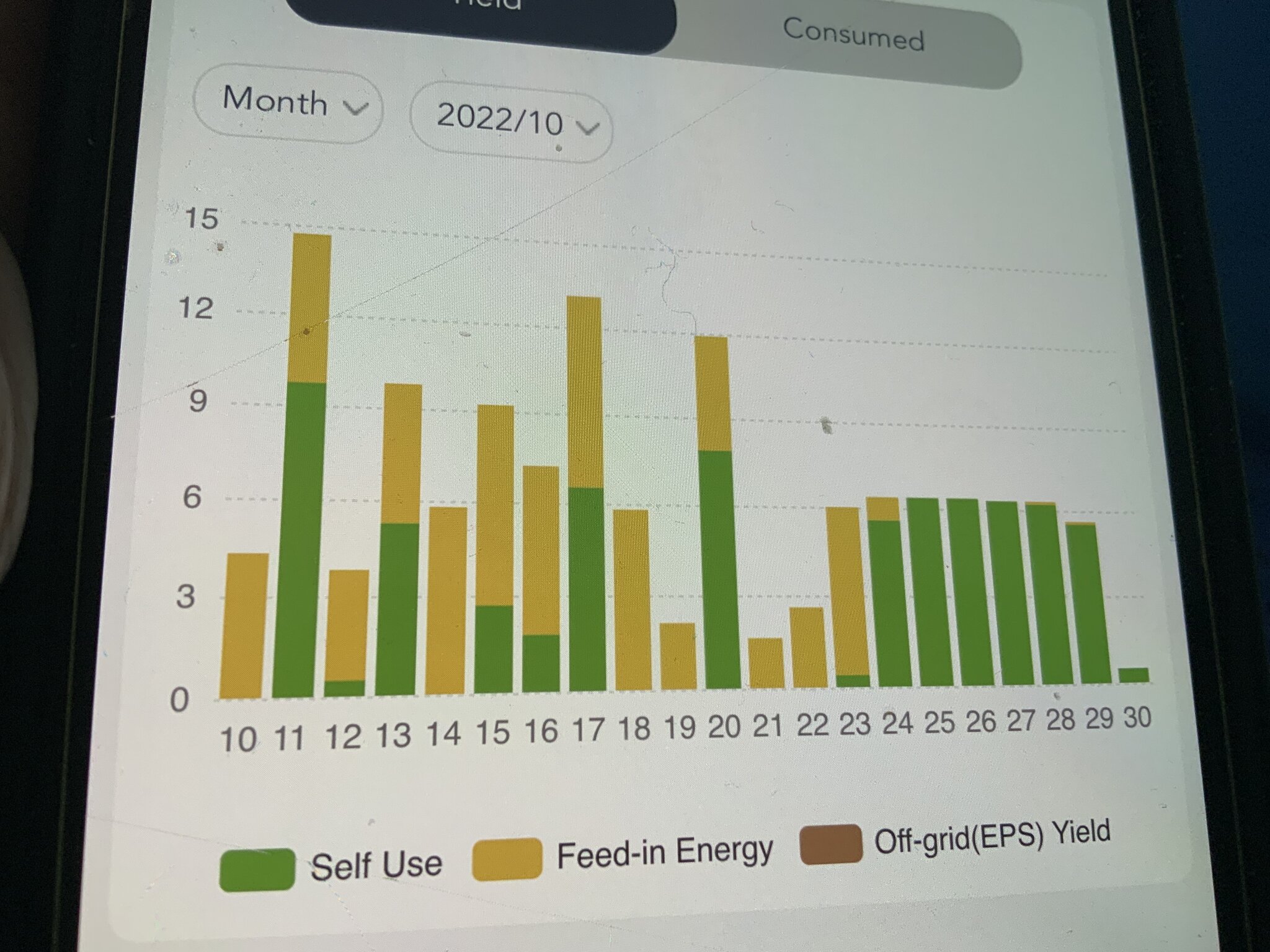

Just had the last four panels and the batteries fitted. Had to have 2 x 5.8kw as the original ones were on back order. Today is overcast with occasional sunny spells, these are on my garage roof so only about a 10 degreesslope. At the moment they are putting 2.382 w into the batteries, nothing major on in the house, tall upright freezer, under worktop larder fridge, Environment positive pressure ventilation unit, one 36” tv on standby and one Ipad on charge. Very pleased with it so far.
batteries installed on the afternoon of the 27/10/2022
