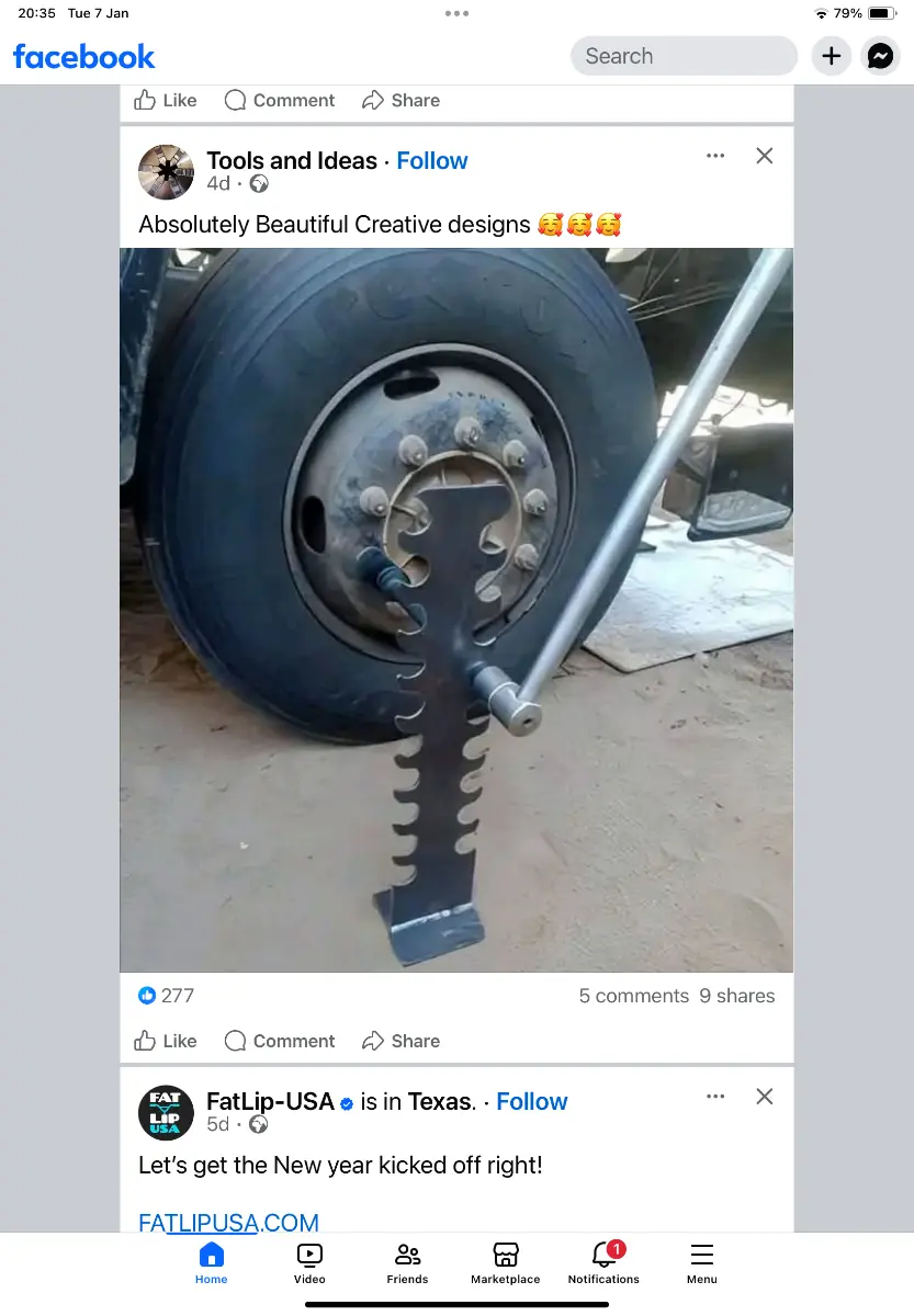

My idea of the 2T Hydraulic Car Bottle Jack has just been improved by this stolen from FB
Anyone know what it is or better still where to find one please ?
Nice but can be replaced by a piece of wood of the right length to meet 2 nuts in line with the hub. Then rotate the wheel slightly for the next two. On a flat tyre it will be close enough to the top nut.
A hell of a lot lighter and cheaper for something you may never use and has more chance of doubling up as useful for something else. If you were a mechanic doing this all the time then of course you'd have the tool posted instead.

I agree 👍 however with my set up and the spacer, the nuts are deep inside the milled hole and therefore the only way to check would be with an extension bar, socket and wrench, and that’s after taking off the outer wheel 🤦 PITA
Wouldn’t take much to knock one up 👍
I was going to say that the one in the photo looks like it's been fabricated at home.
Not a difficult thing to make as you say, and you could even bypass the weld by bending half of the bottom one way and half the other and then screwing it into a block of wood to act as the foot.
Why not just use an extendable axle stand?
Just make certain it's the heavy weight one, they tend to extend further.
How about a piece of plywood with a few holes off set along the length of it light and cheap🙂
I was really only commenting on the device in the photo as the question had been asked where to buy one.
I can't see why an extendable axle stand wouldn't work.
