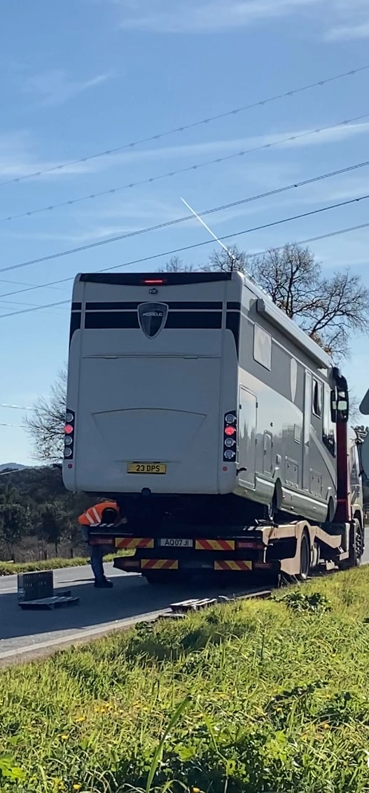

Well what started as a decent journey to Portugal on the 28th December has resulted in us currently in Evora parked outside a truck garage until Tuesday/Wednesday 🤞
To start the horrendous journey, we had a blow out on New Years Eve just over the border into Spain, pulled over into a SOS place and called RAC Arrival. The blow out was on the inner rear wheel, I carry a spare and have E&P jacks but for some reason I couldn’t find my 27mm socket to get the spare off so needed a recovery van to attend.
Anyway the guy arrived within 2 hours and I have to say I didn’t have much confidence in his abilities!!! Anyway fast forward 4 hours later and we were on our way, arrived at our overnight stop and the following morning continued our journey the full length of Spain and entering Portugal at Badajoz, I turned off the motorway onto a N road to our overnight stop on New Years Day and was flagged down by a car who indicated I had a problem with the rear wheels. Got out and to my absolute shock could see 3 nuts and part of the threads all jammed between the inner and outer wheel and consequently found both wheels were held on by 1, yes 1 bolt, the rest had sheared off!!!!!! bearing in mind also is that my Smart car is in the back of the motorhome too so imagine the weight on the back!!!
Incidentally I did hear a slight knocking noise while I was driving but out that down to the fact the spare wheel may not have been balanced but in fact it was the sheared wheel bolts rattling away in the spacer!!!
I again called the RAC Arrival and notified them of the situation, we were stopped on a N road with triangles out and no real way of moving as the wheels could have fallen off at any point. Anyway again a recovery guy came within 2 hours (was dark by this time). He saw the size of the motorhome and said BIG PROBLEM to get recovery that evening so I managed to slowly reverse into a farm entrance and we stayed there overnight. Anyway the following day at approximately 2 pm 2, yes 2 recovery trucks arrived from the same company and a small recovery truck. Loaded me up

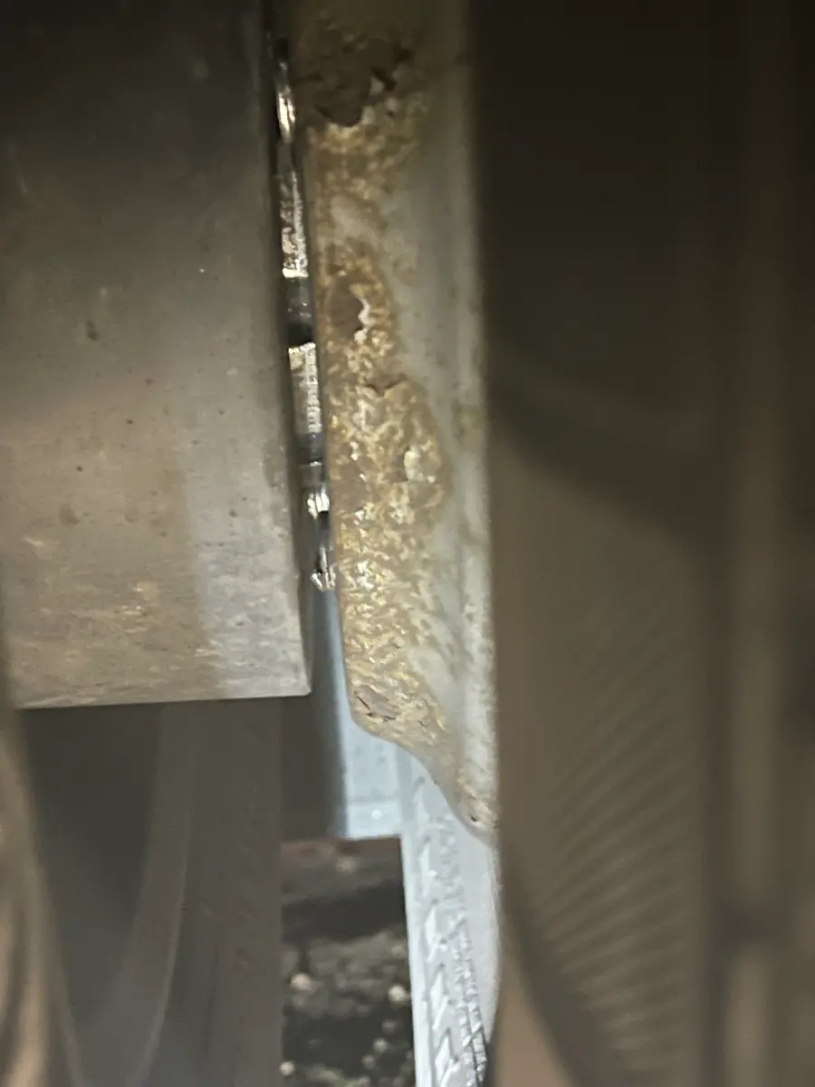

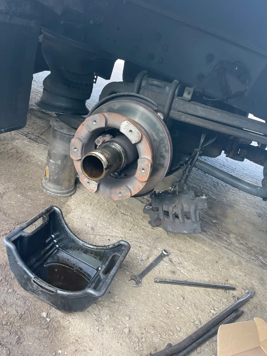

We arrived at the truck garage and they immediately looked at it and said we were VERY lucky to be alive as if the wheels had come completely off then we would have lost control at motorway speed!! They agreed that the cause was the wheel nuts not been tightened at all!!
Now awaiting a new rear wheel hub from Iveco but luckily we have been allowed to stay with the van and been provided with water. Don’t need hookup as got a generator.
I have to say that the RAC Arrival have been excellent in their communication, checking up every 2 hours whilst we were stuck on the side of the road and also phoned yesterday for an update and they will speak with the garage.
I will be putting in a claim with the RAC for the complete and utter incompetence of the first recovery company changing the inner wheel and not even tightening the nuts!!! We could have been dead. I hate to think what the consequences oils have been 😥

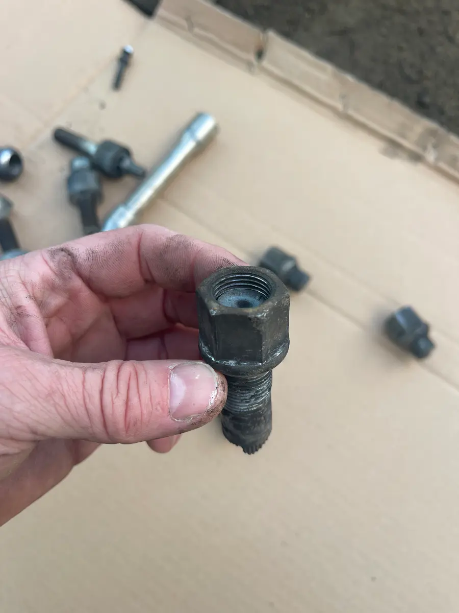

I had no way of checking as in his incompetence he had rounded out one of the wheel bolts on the outer wheel. My intention was to source a new one after arriving at our destination to check the inner nuts (can’t check the inner nuts without taking off the outer wheel)

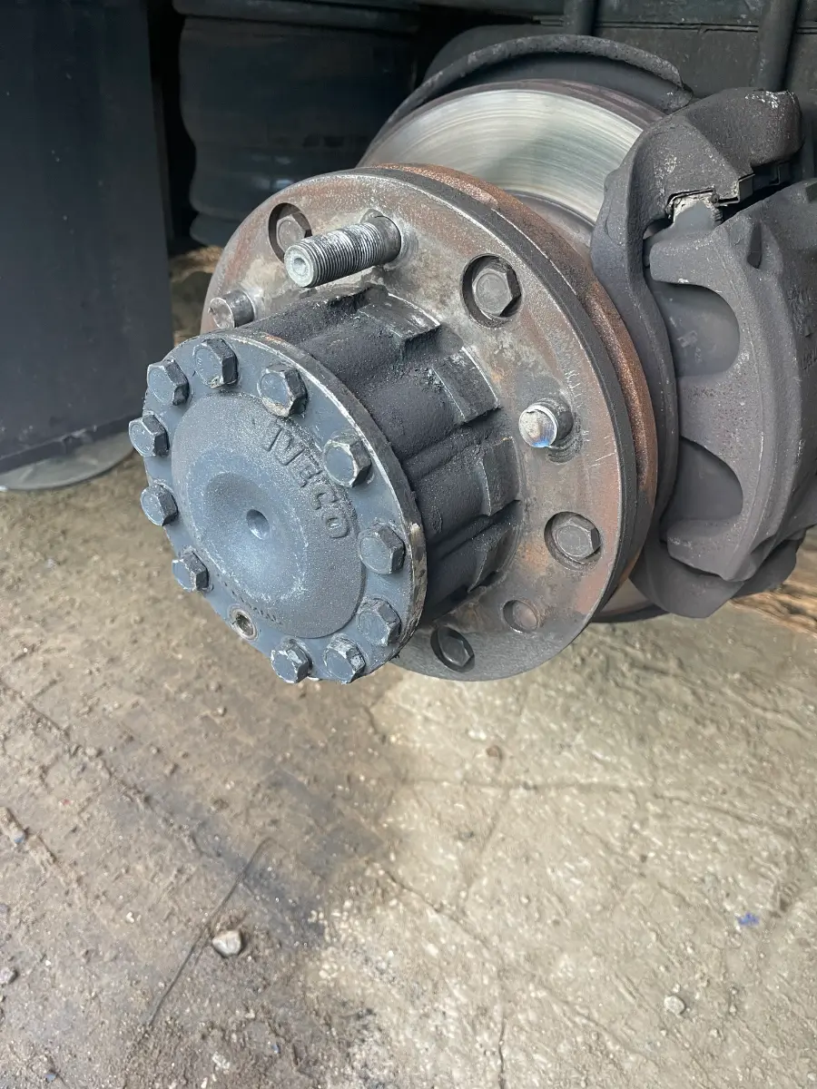

The trouble with this design is that you can’t actually check the torque on the inside nuts without removing the outer wheel, to be fair the first guy had most likely never seen this setup as it’s from Meier the chassis converter not standard IVECO.

Yes Martin same as yours 👍 I couldn’t re-check the torque as he rounded off one of the outer wheel bolts in his incompetence 🤷
I have to admit, in 60 yrs of mechanicing on heavy vehicles, I have never seen rear wheels with TWO securing nuts, spacers yes, but not two nuts! 😱

The inner wheel and spacer is held onto the back axel assembly with 6 bolts connected to the rear wheel hub, the 2 you can see in the pictures are the remaining out of 6, the other 4 sheared off. This is the new part I’m waiting for:

You can see on each of the nuts in my hands the difference in the height of the nuts to the thread, showing they have worked their way to the top of the thread and then snapped

I am assuming you mean two sets of nuts, on our previous daily chassis it was traditional wheels back to back and then easy to check, with the bodies getting wider on these vans they are using spacers to pull the wheels out a bit.
Most of the Trucks and Coaches I've owned have only had one set of nuts but most of the Australian trailor's I worked on had spacers.

We’re they a long bolt or the same as this where the spacer actually carries the second wheel.
