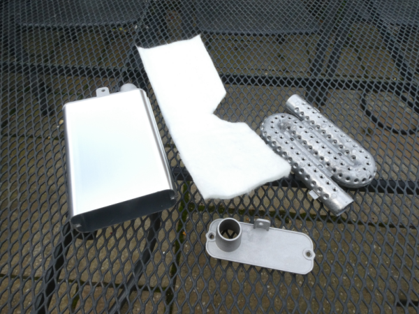

Yes, basic silencer is a bit noisy add a second quiet one and it becomes very quiet. I think you are winding me up but in case you are not:-
No wind up mate havnt seen no silencer just a convurluted pipe hanging down where it exhausts.

The cheap 6 quid one comes with the heaters as standard Two on Tour assures me if you fit the 11 quid one as well they are very quiet.
Removed the two standard with the kit ones and now just using one of the all aluminium ones. (y)
Thanks Lenny that reminded me and also found from that the air filter one so now both ordered
