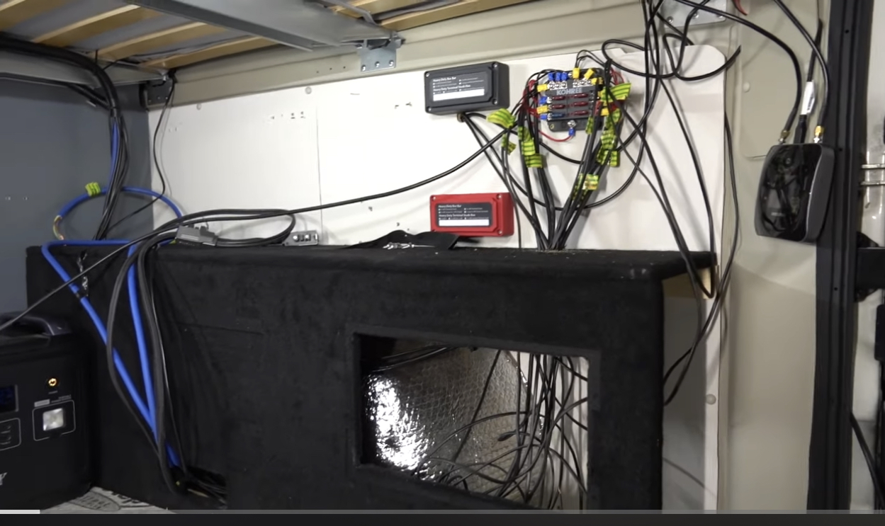

They seem to have been really slow to react . Apparently EcoFlow had a video call with GJ where he explained the situation and how the van could have caught fire. Due to the language barrier the representative was actually laughing while GJ voiced his concerns and basically had no idea how serious the situation was .

It is clear that sizing cables for high currents has to be considered very carefully and consideration given for the length (keep it short), grouping (2 wires together in a braid de-rates them) and the environment they are in (adjacent to heat sources).
They should definitely should not be considered as “in free air”.
Are online calculators perfect? No, but they might just make you stop and think, do I really need that size cable?
