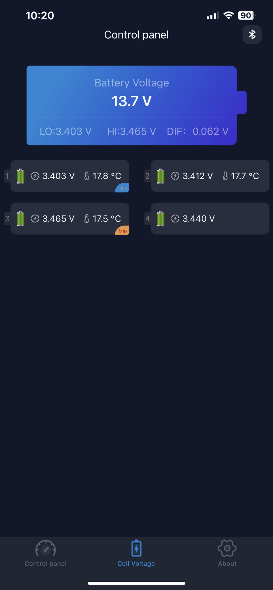

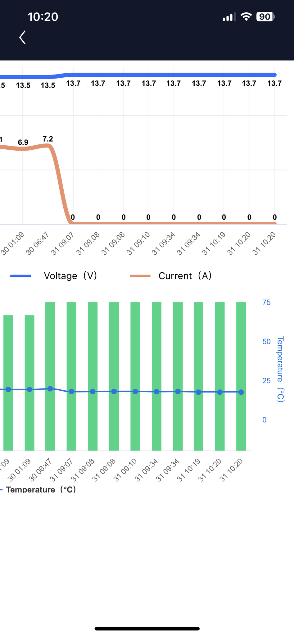

So my brand new 460ah fogstar battery was put on charge a few days ago as it's being installed tomorrow and this was the screenshot i took and then once its charged which was 52 hours later (CTEK CSONE charger at max of 8ah).
Been onto fogstar and they say its normal for the first 5-6 cycles and it will sort itself out as i questioned why it was 100% but only showing 457ah

There's no charge coming in. Doesn't look like it's finished charging

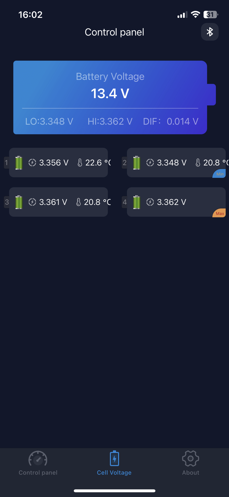

Sorry to hijack the thread but what does this mean ?
Is there anything not correct with these readings
Im on EHU at the moment
View attachment 802223View attachment 802224
Looks good to me it's only 1.1ah down on 230ah and 0.014mv cell difference but it is rested at 13.4v so had time to settle.

If it lasts 10 years i will be truly amazed and if they are even around that long, the sterlings that i have presently i have had for nearly 5 years and i can only monitor them by using the victron bmv as they dont have a bluetooth BMS built in but i have had no issues with them although i would not know if they were not balanced as not seen that in the app. With this new battery i am seeing things i wouldn't normally so not really understanding but with this thread it will give me the information i need to challenge them once i get past the 6 charge cycles if it's still not right.
What is acceptable just out of interest as mine are currently showing 0.062v difference which at present Fogstar are saying is normal and will stabilise after 5-6 cycles which i won't get to for a while yet?
Just leave them on charge for a few days and they should top balance. You don’t need to fully cycle them. 62mv is ok as long as it steadily reduces after a few days changing.
