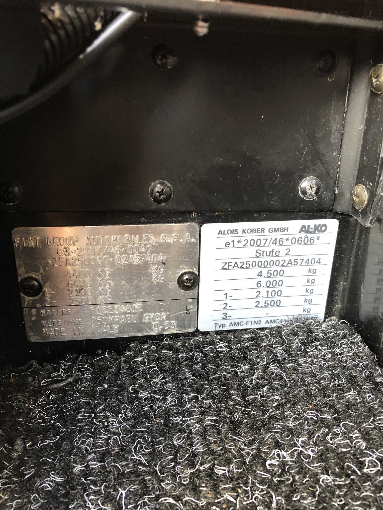

I might be missing something here but there is no stage 3 Carthago plate on my Carthago, just the original Fiat and alko and of course the new updated plate.Not quite correct, the left hand stage 1 plate is the original Fiat one, the right hand one stage 2 is they Alko chassis upgrade one.
As has been already mentioned there will be a Carthago one (stage 3), which will show the weight the van was supplied from the converter to the original first registration order at the requested registration weight, which it would appear in this case to have been 3500Kgs. The registration details used will be on the original CoC.
As many have said before (and more in the future will) a quality built 7.4 metre van at 3500 Kg is in no way a useable one and be legal.
