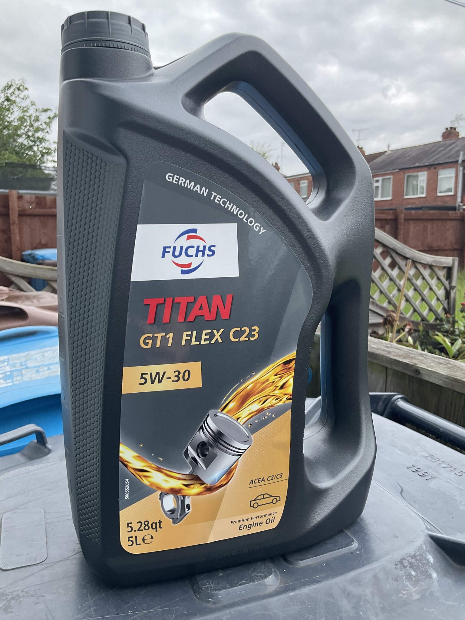

Go to the FUCHS oils website and put your vehicle details in.
I use this in ours (2014 Fiat 2.3) after discovering that it’s what the Fiat Professional dealer used during the five years we had it serviced with them.
Or, if as you said in post #12 you trust your service garage, just ask them for some to use for topping up.
