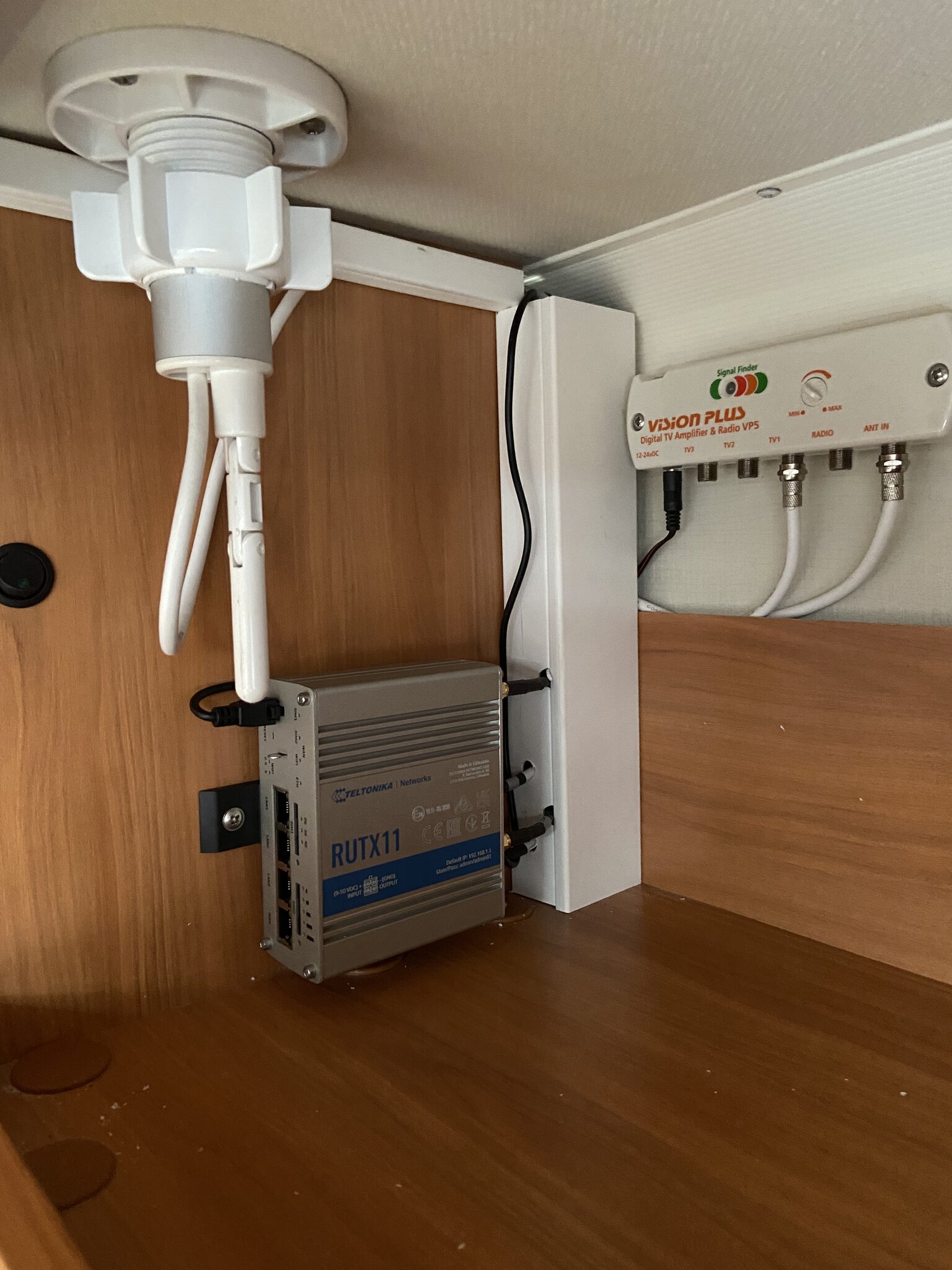

Don’t forget it doesn’t have to be in the same cupboard where the TV aerial is. I put mine in there, with the antenna in the next space along, above the fridge and it’s turned out fine but it could go in any of the cupboards that may result in a better roof mount position. You just need access to a 12v supply.

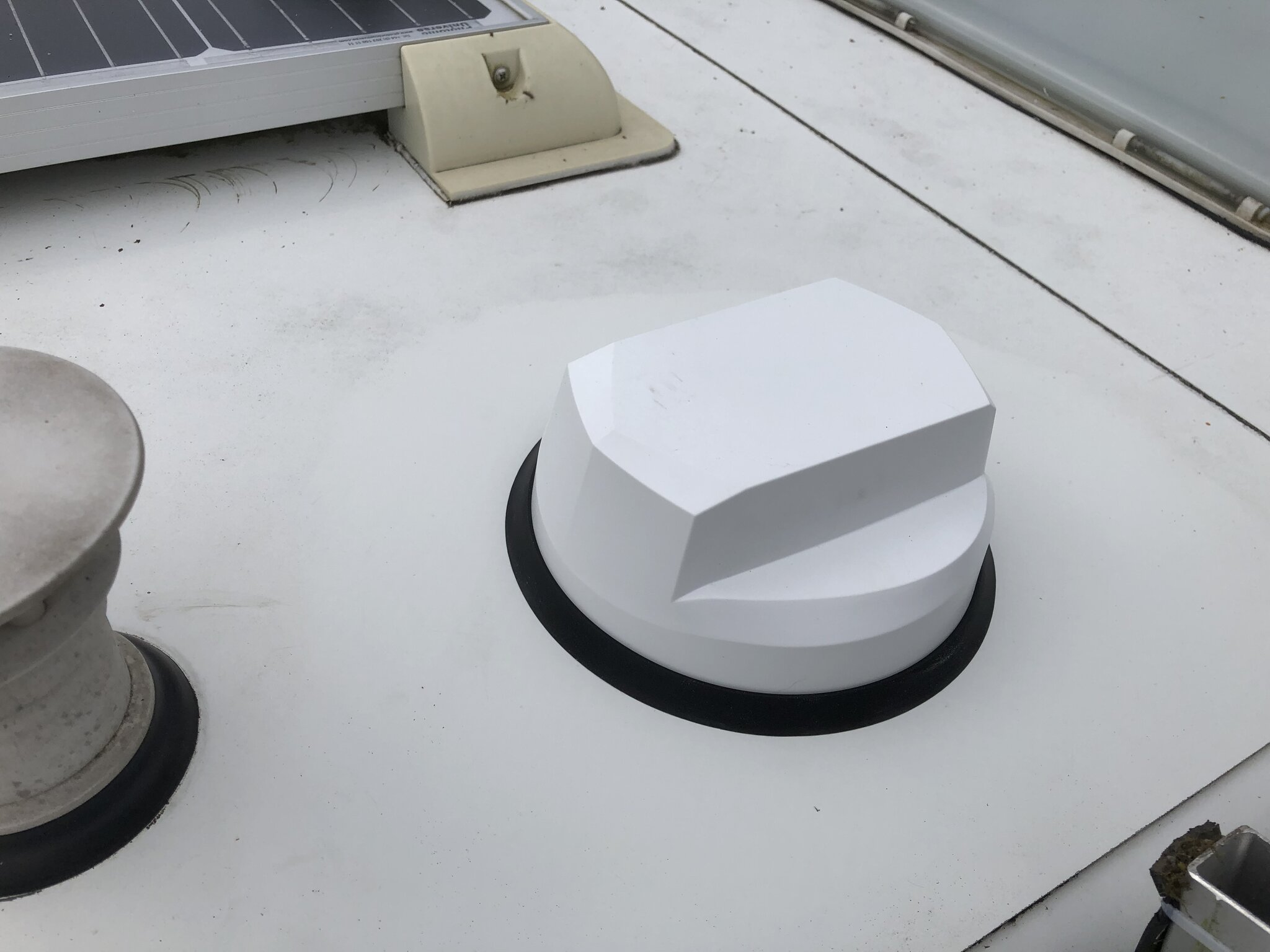

Very good choice of router and antenna I’d say, though I went with the Panorama antenna from Co Star.
Many thanks for your reply and photos. Just for clarity I take it that in the top photo its the TV aerial coming through the roof and not the antenna.
Yes, the antenna is about 18 inches further back above the next cupboard.

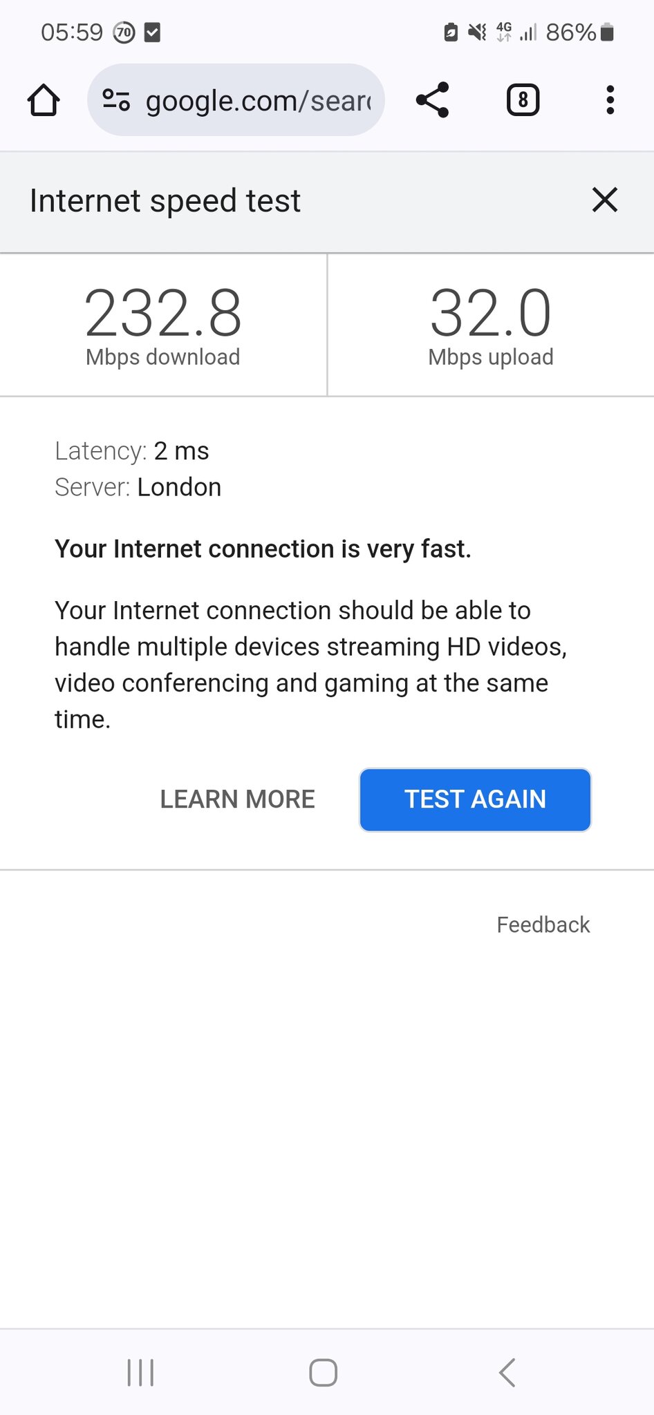

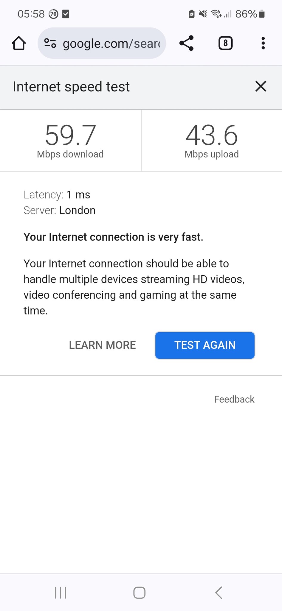

Little experiment, I have a m5001 on the 3 network and my phone (s23) also on the 3 network. I have taken internet speed readings, one using the router m5001 and the other the mobile network on my phone, switched the WiFi connection to the m5001 off on the phone.
The m5001 and phone are in the same locations and no external antennas are fitted to the router.
The phone is much faster.....

With those speeds have you checked your phones wifi is using 5 gigahertz, you may need to enable the 5ghz ssid on the 5001 -> the speed you getting there is about the max you can get on 2.4ghz wifi you see. (2.4ghz wifi despite claims tops out at 70-80Mbit). If you use a laptop on your wifi you can see that its using 5ghz WIFI signal (which will allow up to 500Mbit performance). If you not using 5ghz wifi, thats your answer.
But in general if you in "good" signal, ie, max, the phone will have a higher functional level on the network so thats not unexpected. Roof antenna improve things in bad signal, if you have 200Mbit on a phone they add "little" on a van wifi, in fact with their higher gain can make things worse with interference from adjacent cells.
