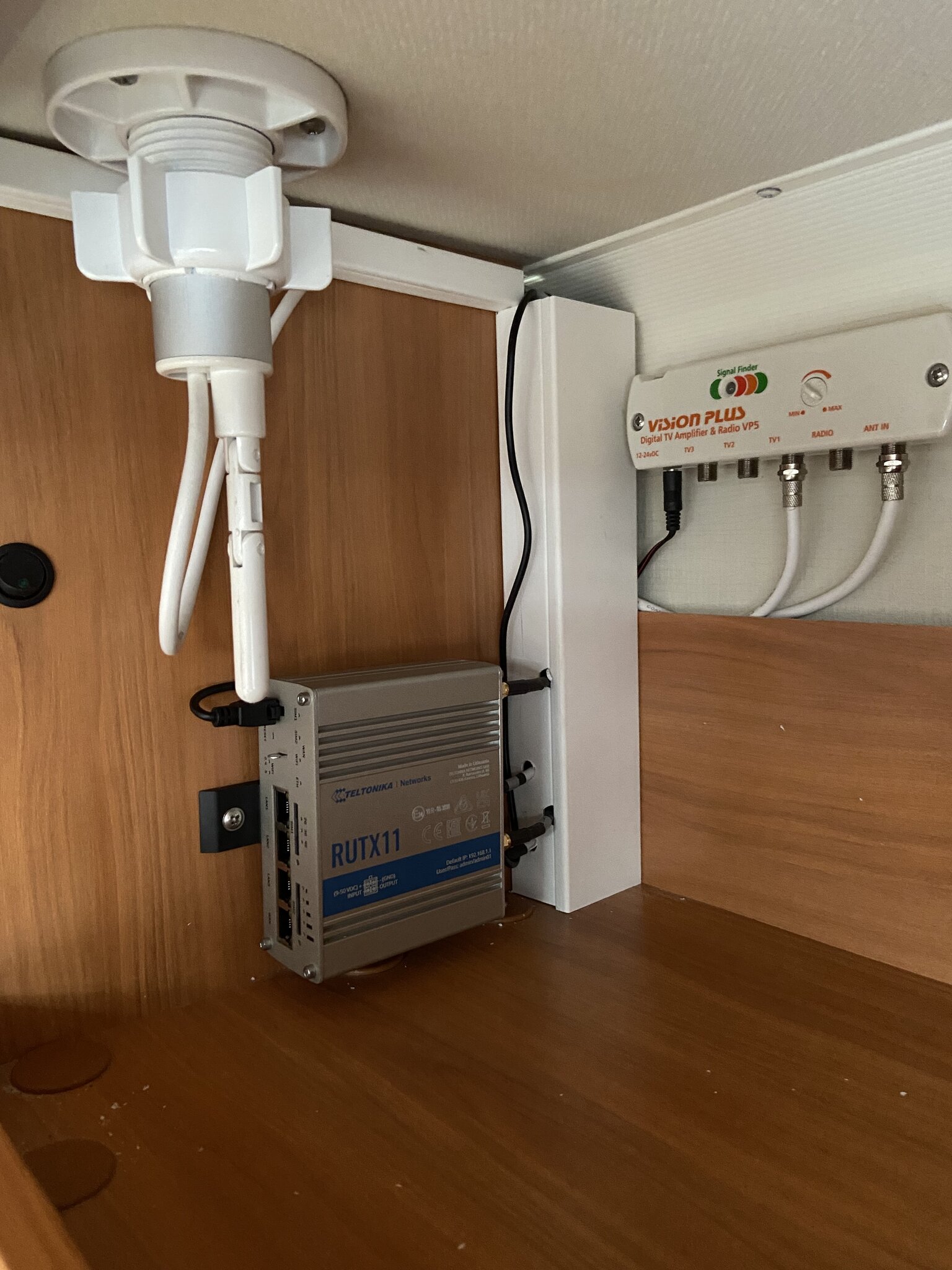

This is mine:

Don’t forget it doesn’t have to be in the same cupboard where the TV aerial is. I put mine in there, with the antenna in the next space along, above the fridge and it’s turned out fine but it could go in any of the cupboards that may result in a better roof mount position. You just need access to a 12v supply.
Very good choice of router and antenna I’d say, though I went with the Panorama antenna from Co Star.
