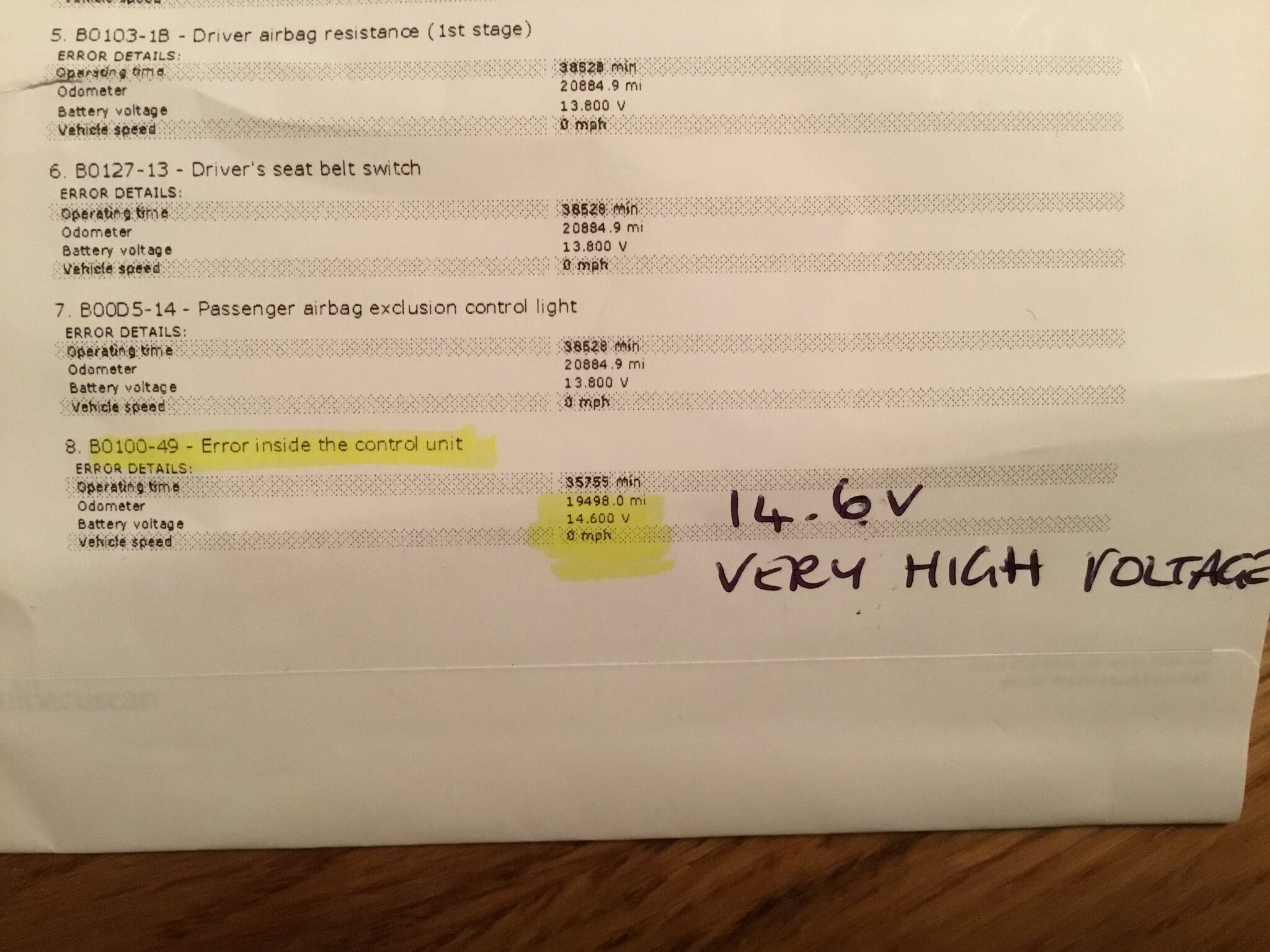

These things are supposed to be voltage sensitive. Since when cranking an engine the battery voltage can drop to around 10v or so, what is the voltage that the airbag ECU fails at?
Mine failed at 14.6 Very High Voltage !!
Crash Data report :-
Being stop/start, my van runs to more than 14.6v when running.
It is really poor design if an ECU errors at a voltage like that - it is relatively easy to protect against.
