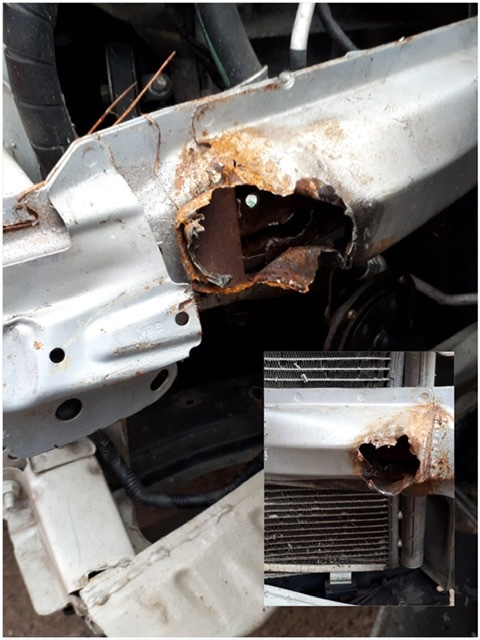

With regard to accidents, see the photo.
Just how much evidence does Conniedriving driving and other naysers need before they will accept there are issues on several fronts?
Just a little extra tidbit, The supplier involved in the current situation sells Cat ‘S’ insurance write off vehicles, converted for a-framing. The practice is not illegal but, the car should be priced accordingly and the prospective purchaser should be made aware of the facts. (Passive Misrepresentation). I’m pretty confident that is illegal! The evidence is there in a current advert, beware if you’re looking for a ready converted toad!

If I understand it correctly, a ten year old flat two installation wasn’t inspected/maintained and failed. The ensuing RTA is now leading to some spurious legal claim on some dubious grounds?
The only useful thing I could have possibly taken from this thread is the detail of the manufacturer; information which ‘could be’ useful as a supplier to a avoid, yet this ‘for information’ thread doesn’t deliver on this (possibly) most useful piece of information!

Should it not also be about poor servicing, because from original photos I fail to see this as happened recently when was the vehicle's A-frame installation last serviced, a regular service could surely have prevented this
It should, but the company in question never suggested or offered an inspection/servicing regime, whether it be on installation, or subsequently!
I was told which parts of my A frame needed servicing but nothing was said about the the parts attached to the car, other than the Bowden cable. I have never serviced the towing attachments bolted to the motorhome either. How many people do? I, perhaps naively, assume that the bits bolted to my motorhome and car are designed for the job and competently and permanently installed.
The pictures shown suggest that in this case the A frame was simply attached to an existing cross member that was not designed to take the stresses and strains. I have always understood that this is not safe. Perhaps a visual inspections might have revealed some rust but I doubt many owners know how to spot metal fatigue before it fails. My personal opinion is that no amount of servicing would prevent failure of something that was always structurally inadequate.

No, I wasn’t present, I didn’t know the others back then, however, just in the last 3 weeks an incredible amount of evidence has come to light, highlighting their malpractice, both in fitting terms and marketing/documentation terms.
I’m unable to elaborate at this stage.
I would like to know on what basis the insurance claim was made...
It wasn't an accident
Why wasn’t it an accident? Most accidents have an avoidable cause and an element of negligence, that is why we have insurance.
The claim by the user was like any other claim, on the basis of an RTA. I’m not sure who the company was but they settled quickly, no argument, and double the market value of a similar car of the same age, due to it’s extremely low mileage and former condition.
they’ve also put a temporary block on the disposal company moving it on, pending an inspection by a specialist assessor (nothing to do with the payment).

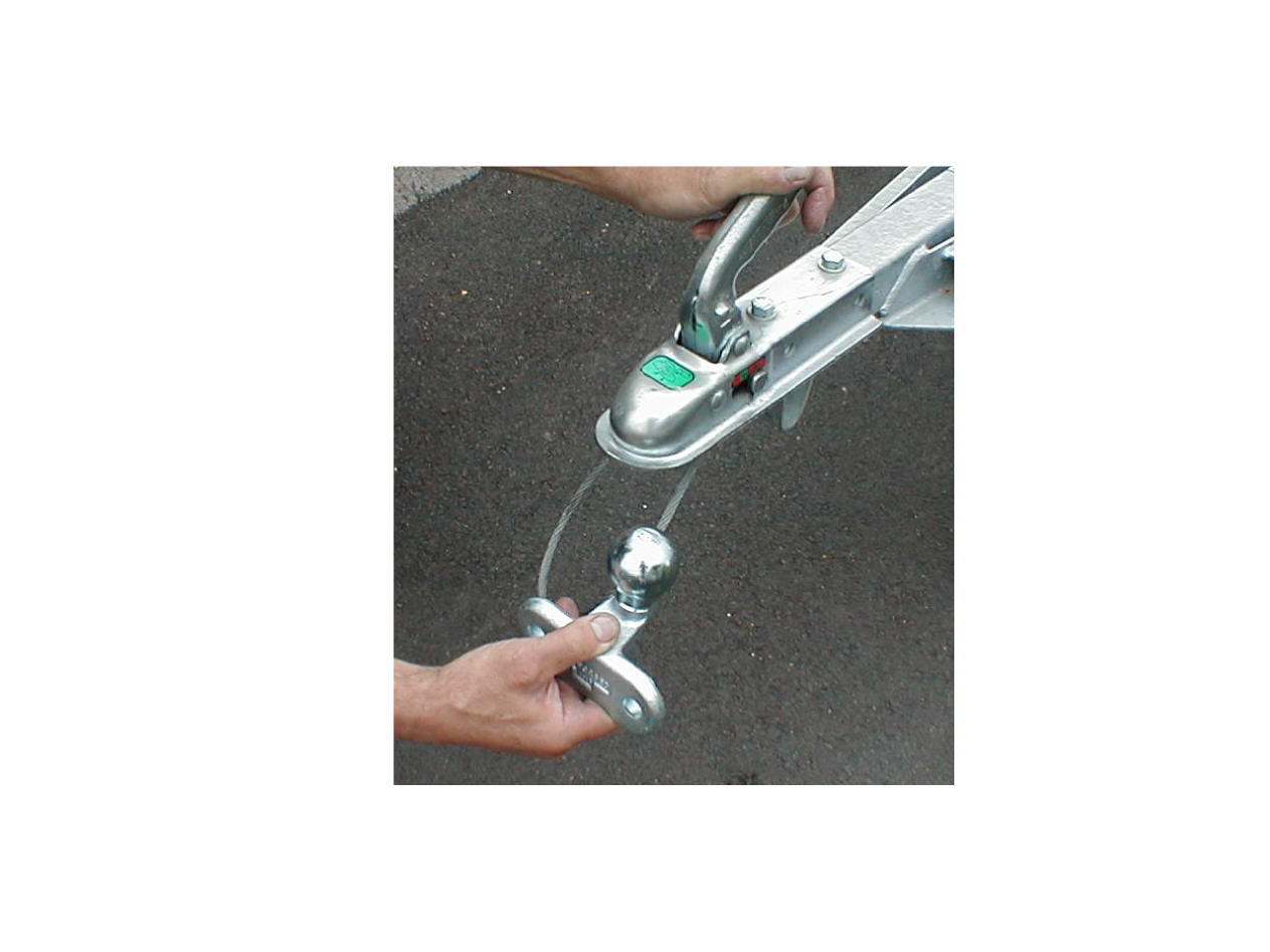

Trailers up to 1500kg do not have to have a break away cable, a secondary coupling is also permitted. Did this A frame have a secondary coupling?
Reg 86a of the Road Vehicles (construction & use) regulations 1986, amendment 551 (introduced 1995).
There was no secondary coupling fitted.
A secondary coupling would normally take this sort of form. (See photos).
It needs to be short enough to prevent the front of the coupling striking the ground and to retain residual steering.
