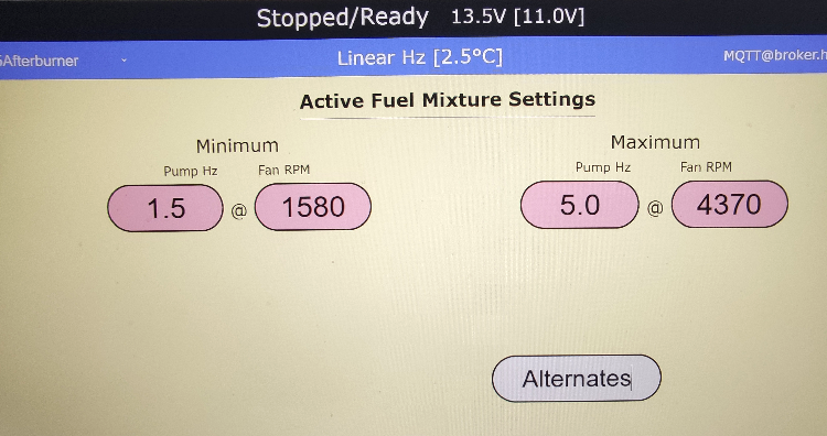

You used to be able to tune the Chinese diesel heaters by adjusting the fan speed via the controller menu to get lower CO levels, but the ECU's in the newer heaters have been evolving so I do not know if this is still possible.
Because I'm running an Afterburner heater controller I have the ability to adjust the fan speed at the lowest and highest fuel pump Hz and by adjusting these fan speeds along with a CO meter at the end of the exhaust pipe I can tune my heaters to very low CO levels which in turn is a clean burn of the fuel.

My low Hz is set at 1.5Hz and I keep my burn chamber temperature at 135C or thereabouts as although the heater is running at 1.5Hz the Afterburner adjusts the fuel rate to maintain the hab area temperature thermostat setting.
