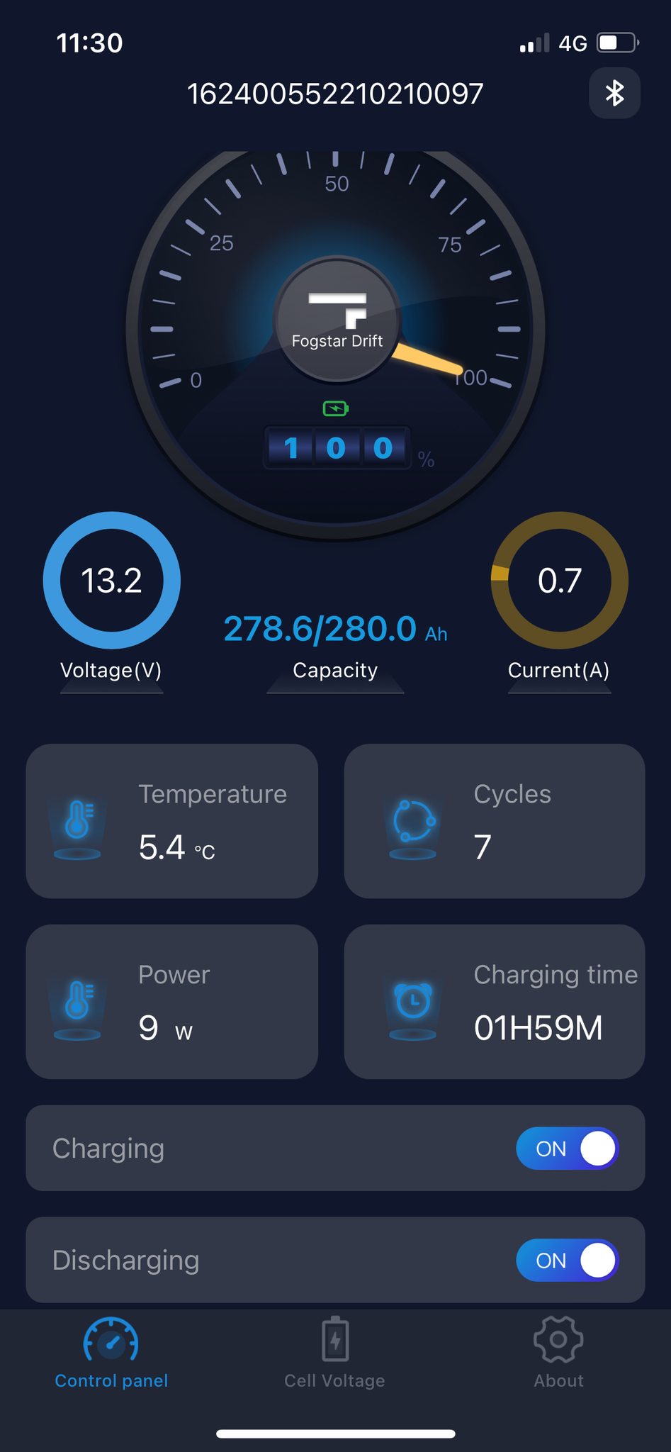

Well my 300ah fogstar was installed back in September have used van several times have usually check app to ensure charging is ok and it is.
