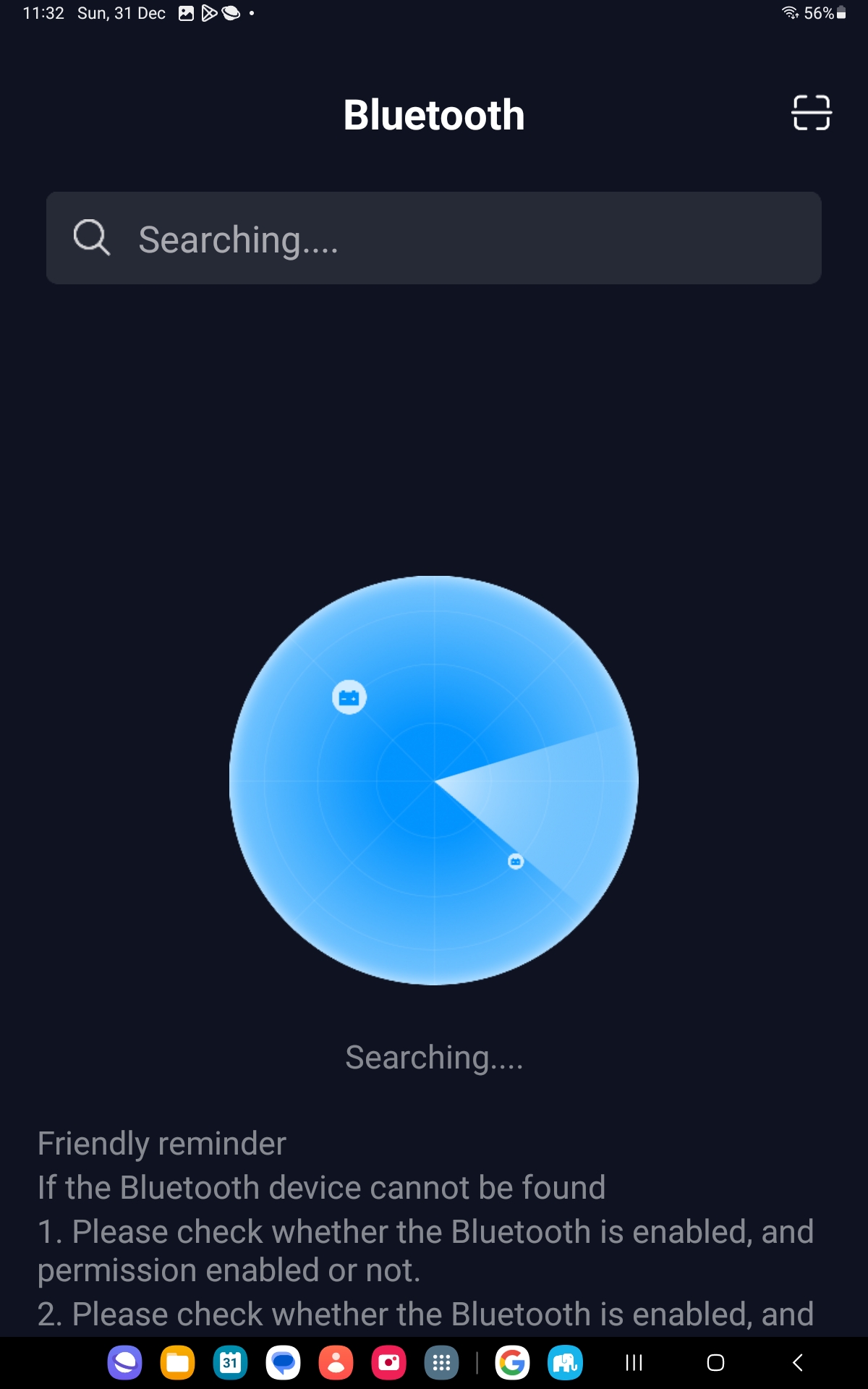

Anybody having problems with the app ?
I received 2 x 105AH Fogstar Drifts today.
I down loaded the app on to my phone but no matter what I do my phone just searches and searches and doesn't connect.
I have also down loaded the app on to my tablet but that won't connect either.
I have Bluetooth and location turned on on both devices and have uninstalled and re-installed the app several times on both devices but still no joy.
I can connect to other devices via Bluetooth no problem.

And this is the Fogstar app not connecting. View attachment 849618
I’ve just tried the Fogstar app whilst sat here in the conservatory
it’s connected to the tv in the conservatory, Apple tv in my demo room downstairs and bedroom to upstairs
