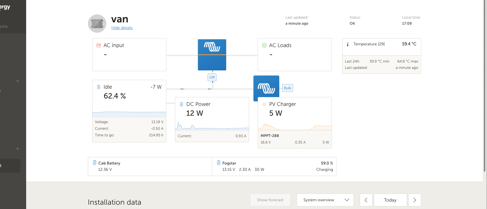

Also found some code to BT to the Fogstar battery, took a while to work out (I am not a programmer or familiar with code) but got there in the end. Been on test since for 5 days or so and all good. Fogstar doesn't give "time to go" anywhere on the Venus display but can live without that and you can't have the Fogstar and the Smart shunt on the screen display at the same time but it is available on VRM.
Works with my BT keyboard and hopefully will be good with some Ruuvi tags and a Mopeka LPG unit. I am concerned that the BT stack will lock out with the Fogstar constant code but will see when testing.
