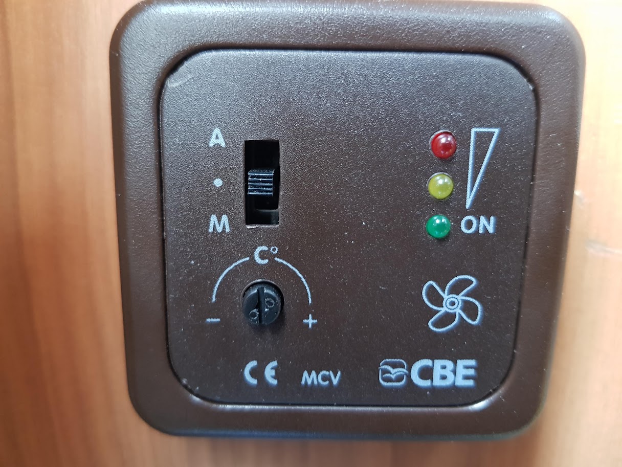

The dealer fitted it for us. It is a kit with manual and auto options.
It transformed the performance of the fridge/freezer.

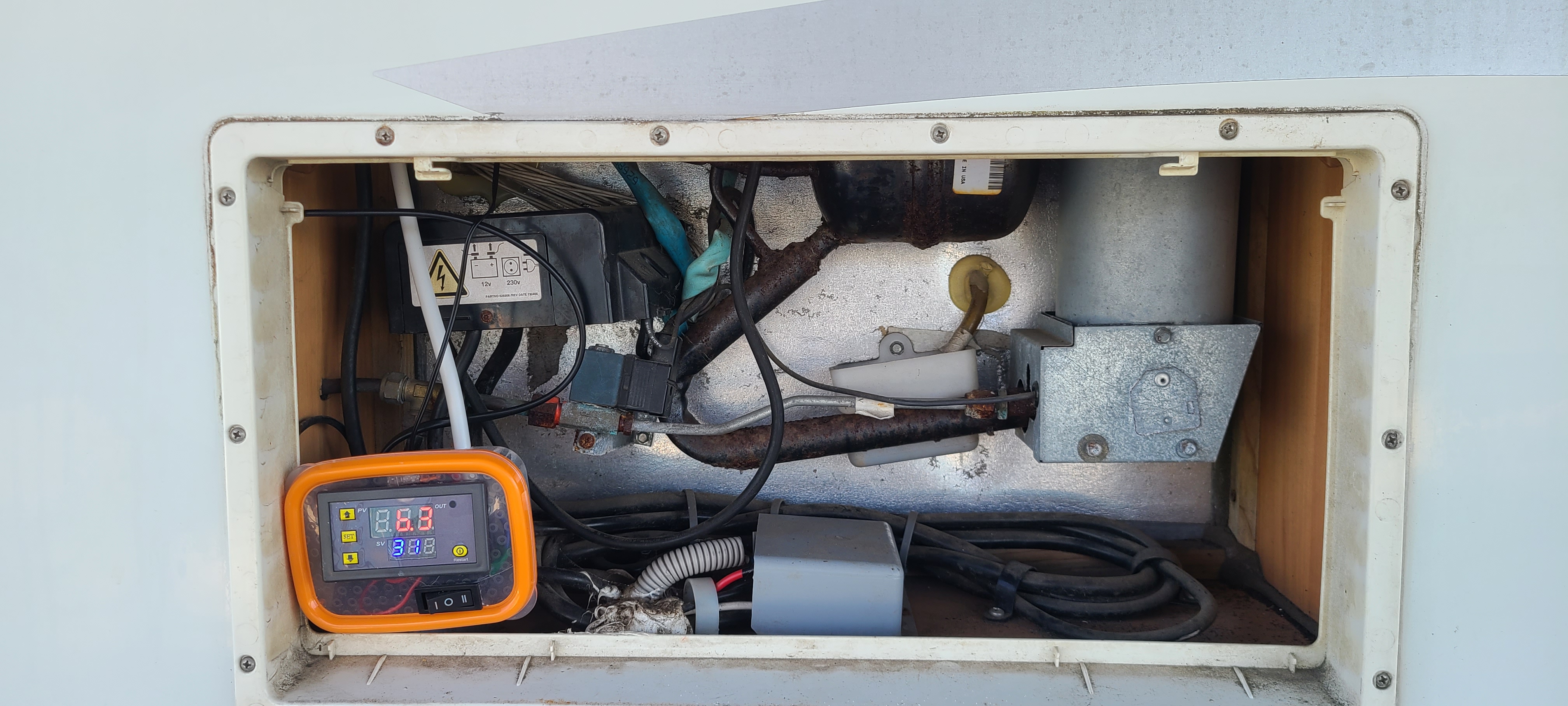

Very easy to do with 4 x6" computer fans and a thermostatic switch which cuts in when the air temp hits a preset figure. Whole cost of bits around Ā£20.

Has anyone fitted a fan behind the fridge for extra ventilation in hot weather?
Yes
Are they successful?
Very
Very easy to do with 4 x6" computer fans and a thermostatic switch which cuts in when the air temp hits a preset figure. Whole cost of bits around Ā£20.View attachment 918396
20230908_142013-jpg.918397

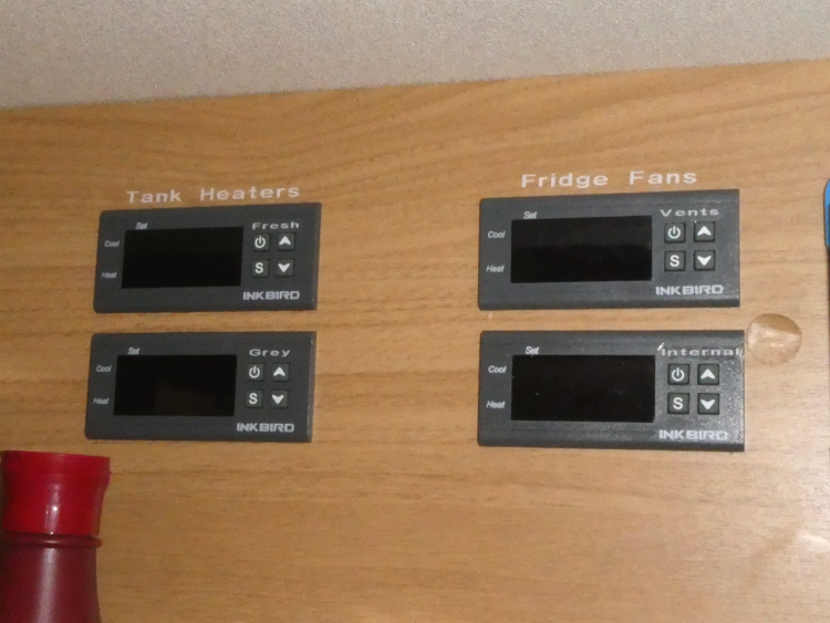

Why do you have the controller outside? I have mine above fridge and next to a digital fridge temperature gauge so I can easily adjust the cutin/out fan temps.
