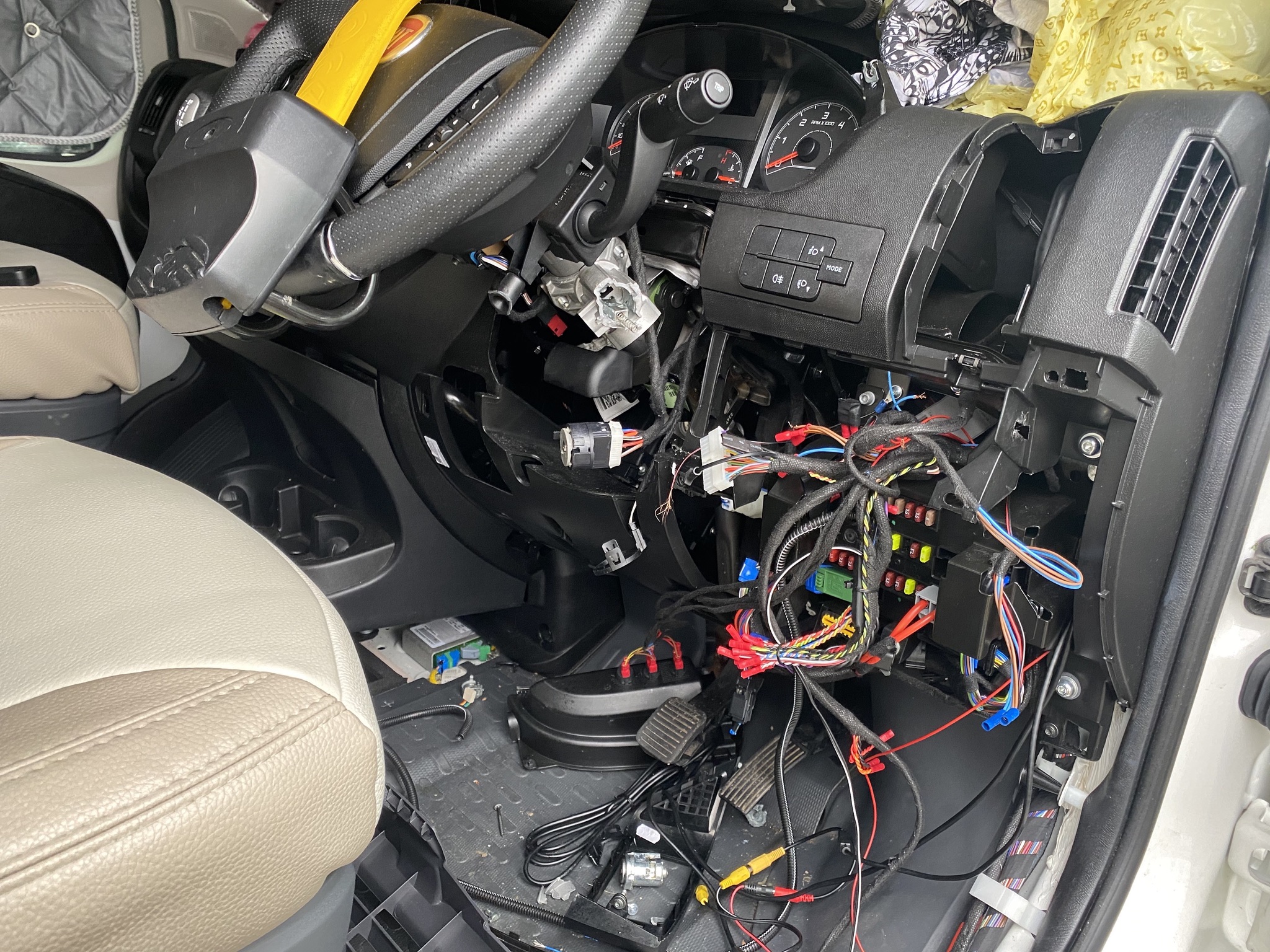

Hi
We have a Knaus box life ( it’s a panel van shape) sadly this was stolen last night )
We have a tracker and I’ve recovered the vehicle this morning but they have destroyed the ignition ( barrelled it). They have also damaged some of the trim in the cab presumably checking for a tracker
We live in London and worried this may happen again
Questions.
1. What are people using for van security I’m now considering deadlock fitting and a retrofit alarm and steering wheel lock and wheel clamp
2. Any suggestions of where /how to get the trim replaced
3. The guy from the tracking company suggested fitting a kill switch to the fuel pump and suggested this could be done for just a few quid
Any comments on the above and suggestions gratefully received. We love our van but also can’t splurge on every single security device going so would be grateful to the forum for advice

We have a Disclok gold steering wheel lock . It is excellent - comes in small, medium and large.(Just measure the steering wheel) Before that we used a Milenco steering wheel lock bar - again excellent. It is now on our car.
Just invested in a Milenco pedal box which covers brake and clutch pedal on our Peugeot Boxer base.
We did look at a Milenco wheel lock but that needs the wheel cover taking off every time you use it to put the Milenco bar on a wheel nut.
Ironically,the latest edition of Practical Motorhome has an article on motorhome security.
Hope this helps.

  • Tiwee window alarms
  • WOMO window metal security clamps
  • Thatcham Alarm
  • Milenco steering wheel bar
  • Extra Ed-Lock dead locks on all doors
  • Metal chains to secure all doors once inside
Also have a panel van conversion
Mar 7, 2022
224
590
87,297
Hobby Optima T70 HQ
Deadlocks
Pro plates
Hab door lock
Tracker
Growler with immobiliser
Steering bar
Pedal lock
Captains seat disc lock
Safe
Cctv in and out.
Lock out window locks
Maybe over the top but it gives me peace of mind. Great to be able to check on the cctv when we are away from the van especially. Each item may not be infallible but it slows them down.

For those without rotating seats just slide seat towards steering wheel, on door side drill through both sliding tracks and fit a decent padlock .
On the inside tracks drill through at least twice and fit locks with key side underneath the seat.
Best of all is similar to a Verisurehome alarm system whereby you can detonate a canister of tear gas inside the van by remote control mobile phone signal, same as a bomb is detonated.

A hidden kill switch is damned hard to work around. Took my matena week to find it in an old classic mini he was renovating. Turned out to be an ordinary switch on dash that was labelled for rear window demist or similar.

Glad you got it back - Get a 'Ghost' imobiliser.
My brother had one fitted to his Mercedes G Wagon. Very 'gangster' I'm told! (and he's a 76 year old farmer !) ...but I thought what a great thing for a motorhome, so got one fitted very soon after hearing all the horror stories on here.
You have to do a set of actions on certain dash controls to start to vehicle ( nothing to be seen in vehicle at all) This is programmed in and is as simple or complex as you want - you can even change it yourself to something you find easy should you wish.
They have a great back up service plus an emergency procedure card you carry should you forget your sequence.
As far as I'm concerned it seems to be about as good as you can get and so simple
(I could give you my 'Ghost sequence' as a working example but then I would have to kill you all!!)
All joking aside like a lot of people we have spent an awful lot on extras and I know in the event of losing the van we would never recover the cost, so it really is very worrying that even the most modern vans today are still being stolen.
We have 'Phantom' tracker on a lifetime deal and a upmarket rising post at home with a 'sold secure' barrel lock so nothing to chop off!
At night when we are away all we have is Brian our Scottie dog (useless) - another upgrade needed!
'Ghost' is £450 fitted. (It even has a valet/service mode that will give someone limited use which is very useful too)
Hope you get everything back together soon

We have the full Vanbitz Raptor setup but I also have a steering wheel lock and when we go away without the van I put on a wheel lock as well. Last week I fitted a Oxford motorcycle lock to fix the driver seat in the reverse position. I think visual stuff is almost as important as the unseen, alarms, ODB isolator, tracker etc. etc. It's not impossible to drive the van with the seat turned through 180 degrees but it's another thing that might put them off.View attachment 923637
Hello, I have fitted one of these as well, however, I attached it from underneath to avoid the body and key slot being damaged by the stealer and if it is not removed you may have trouble yourself in removing it. Whereas if it’s the other way round I believe it is still not easy to remove as there is much less to attack and it would also rotate making it doubly awkward. Having said that it is much more awkward fitting it from underneath, but you do get used to it!
As you can see, I use a square washer to adjust the spacing which I also believe would make removal much harder.

I’ve posted before but the VanBitz immobiliser stopped my son’s MH being stolen, this is the mess they left but it was quickly sorted with the fantastic back up service.
Personally I’m less convinced about the alarm as I set it off once in a very busy seaside car park when I dashed back for a wee. Didn’t know how to disable it, so personal comfort came first 😉 and no one came to see why the alarm was going full pelt and the hab door was open.
What do they thieves do with the MH when they cause all this damage?
Are they sold abroad or stripped down?

Have a moving intelligence senitel, tbh not too impressed the power to the unit was cut after poor installation by dealer from new and we drove from Paignton to Dawlish, stayed 3 nights and the tracker still said we were in Paignton. I rewired and soldered cabling when home, repositioned alarm module but in a fiat its less than 5 minutes to rip off dash to find where generic places for system. Have installed a siren behind fuse panel via a hidden switch off a switched live fuse so hopefully will be quite loud in cab !!!

Where do you store your van when not in use - on the road? on the drive, behind the building line? easy line of vision for the thief etc. I'd work out who and how the thief worked out how easy it was easy.
If you can, a steering wheel and a clamp are musts and in vision - will deter or to move go another place. Gates, noisy gravel, lights might help. Secure off site - CaSSOA for example.
Give up motorhoming, living in London. Some areas, not just London, are high risks. Seriously, visible secure is a good starting again.

Hi
Again thanks for all the suggestions
Deadlocks and plates are working out to approx £300 a door plus VAT 4 doors £1200 plus VAT (not sure if I can stretch to this now) :)
Killswitch have a quote for £60 + VAT (doing this)
Steering wheel possibly should have gone disk lock but have got the Stoplock Pro Elite - like the fact that it is so quick to put on and has fair reviews online - I think the idea of a removable steering wheel is genius
Wheel clamp -- Have bought a bulldog auto clamp - to be honest seems a bit fiddly and expensive
Swivel base lock -- Found this video and will likely do on our return don't think I will have time with work to sort this before leaving
Pedals will likely buy ATE Fabrications.
Alarm - agree the Vanbitz option is a very good one and fantastic service over the phone but with time constraints I think will be impossible (not their fault). Although they have contacted me with another date so will update if I manage this.
