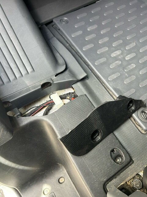

Hi
We have a Knaus box life ( it’s a panel van shape) sadly this was stolen last night )
We have a tracker and I’ve recovered the vehicle this morning but they have destroyed the ignition ( barrelled it). They have also damaged some of the trim in the cab presumably checking for a tracker
We live in London and worried this may happen again
Questions.
1. What are people using for van security I’m now considering deadlock fitting and a retrofit alarm and steering wheel lock and wheel clamp
2. Any suggestions of where /how to get the trim replaced
3. The guy from the tracking company suggested fitting a kill switch to the fuel pump and suggested this could be done for just a few quid
Any comments on the above and suggestions gratefully received. We love our van but also can’t splurge on every single security device going so would be grateful to the forum for advice

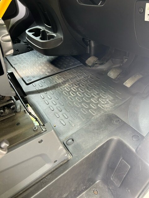

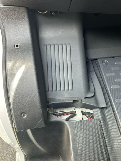

Any advice as to an easy way to find the trim sections for inside the van front doors on the floor in the cab much appreciated and the cover for the leisure battery under the front seat photo attached (you can see the ignition in this series as well)
