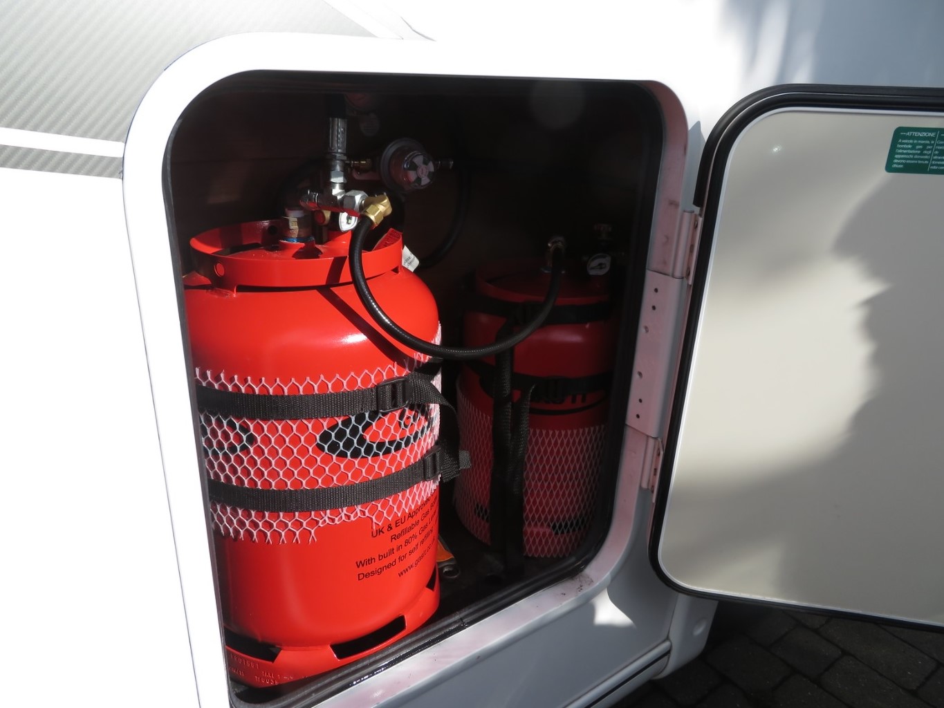

I have installed Gasit with
one 11Kg & one
6Kg Bottle, the filler connector is on the outside wall, next to the BBQ outlet, when the 11Kg is near or is empty, we fill it up on our next fuel stop, we don't really worry about fill-ups, but we keep an eye on where we are going and where to fill if needed, also use a Truma Gas Level Checker (see photo) which I use when filling up with fuel just in case I need gas as well, also get the adaptors for Europe.

Do you just use the one bottle?
I have read advice here that you should swap between them, or else the unused one can be overfilled.
I guess it doesn't need to be every time, just occasionally use the other one.
Never had a problem when one runs out Next time we are on the road go to the nearest LPG garage and fill up
They are both joined, each has a shut off valve, so can keep both opened, or can turn each off individually, I keep both opened. Quite a few years ago, we used to have a caravan, we to exchange the Gas bottle, when in Europe we had to carry two bottles, one being a European one, so was not always easy to find refills, but using Gasit is great, don't matter where we go.
