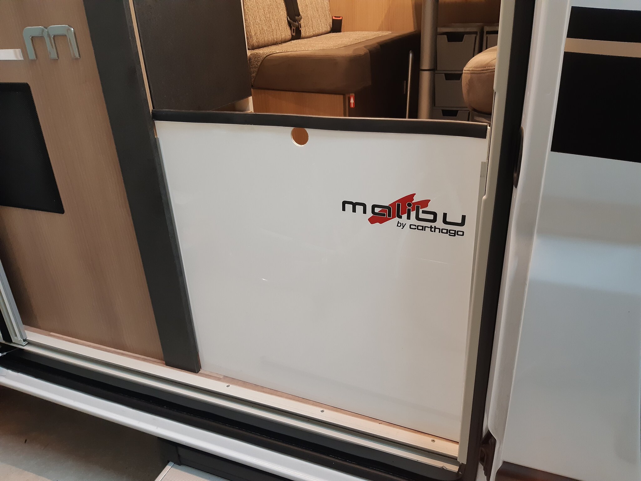

But the dogs can’t see out to bark at passers byI'm bringing Tams thread back to doggies here for a bit.... and with what I've been up to today, so any PVC owners with fur babies have a wee look at this it's even better than something of Blue Peter!..... of course its not 1 size fits all you have to make it according to your pup size lol (and here it is being demonstrated by my crew, Iggy, Hector & Bleu)
Brilliant idea. We bought a tension rod baby stair gate for our 40kg Labradoodle. He never once pushed on it or tried to get out.I'm bringing Tams thread back to doggies here for a bit.... and with what I've been up to today, so any PVC owners with fur babies have a wee look at this it's even better than something of Blue Peter!..... of course its not 1 size fits all you have to make it according to your pup size lol (and here it is being demonstrated by my crew, Iggy, Hector & Bleu)

The gate part is just 5mm acrylic sheet i cut to size, and the groves are 8mm aluminium U channel,CaptainPaul thats great. Very professional looking. What is the gate part made of? And where did you get the grove things?

Paul the top edges of the channel need rounding off if you slip and fall against them you could get a nasty injuryI'm bringing Tams thread back to doggies here for a bit.... and with what I've been up to today, so any PVC owners with fur babies have a wee look at this it's even better than something of Blue Peter!..... of course its not 1 size fits all you have to make it according to your pup size lol (and here it is being demonstrated by my crew, Iggy, Hector & Bleu)
I'll get onto that tomorrowPaul the top edges of the channel need rounding off if you slip and fall against them you could get a nasty injury
