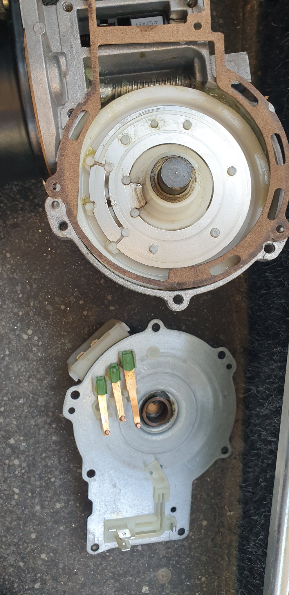

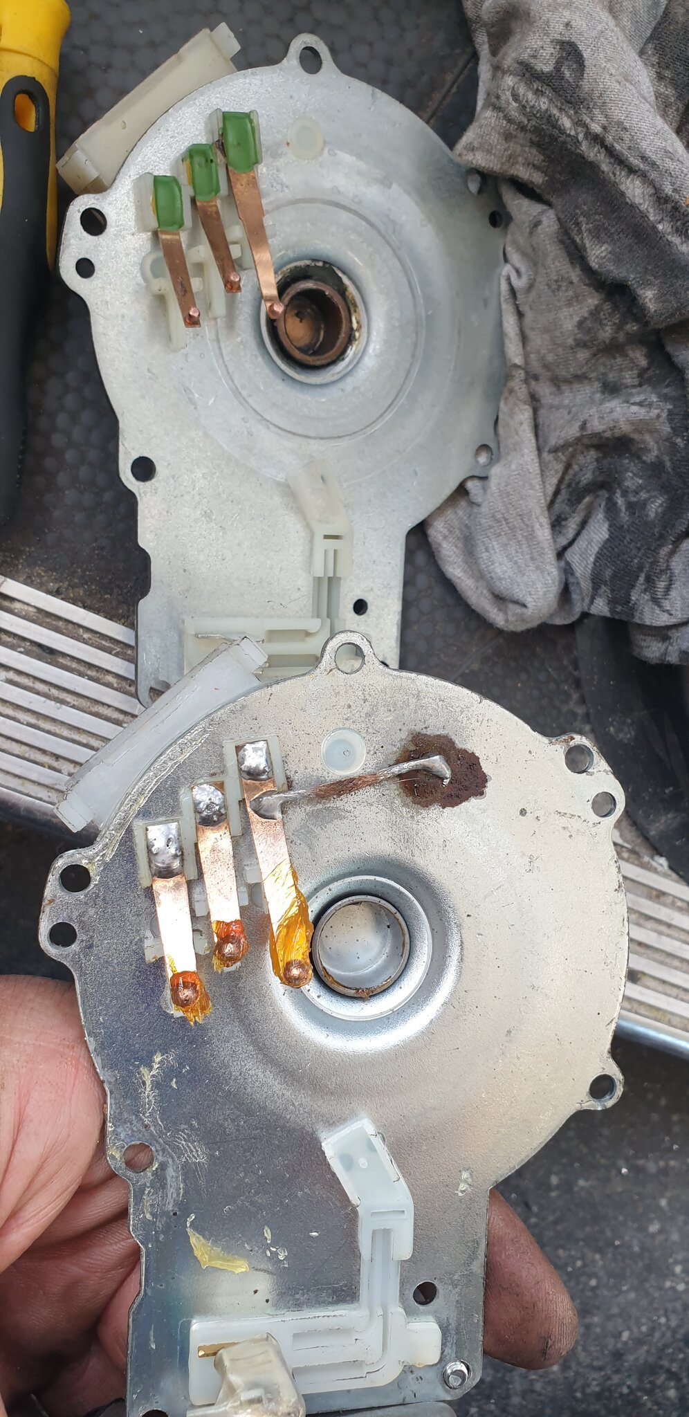

Ok so having tested all the wires and getting the power i should be getting apparently ive taken the motor apart again checked all the connections etc ....from what i can see the park is simply provided by a gap in the steel ring
Heres photos of inside the motor etc and the plug
The wires to the plug are as follows
Brown / black live from ignition
Black/grey. Speed 1
Black/white/red speed 2
Brown ...earth i assume as all other earths are plain brown.
Black/purple ...this wire goes to a plug in the back of the fuse box ...not sure what its for but dont seem to get any reading from it
The plain brown goes to the inside prong
Brown black to the middle prong
Purple/ to the outside prong
Black/grey and the black/white/red go to the red and green wires which go to the motor for the speeds.
So from that it looks like the park switch is the outside of the metal ring
Now these pics show inside the new motor which is a cheap copy compared to the original motor ...on that theres a big section out the ring.
I do wonder what the black/purple wire is meant to do though
