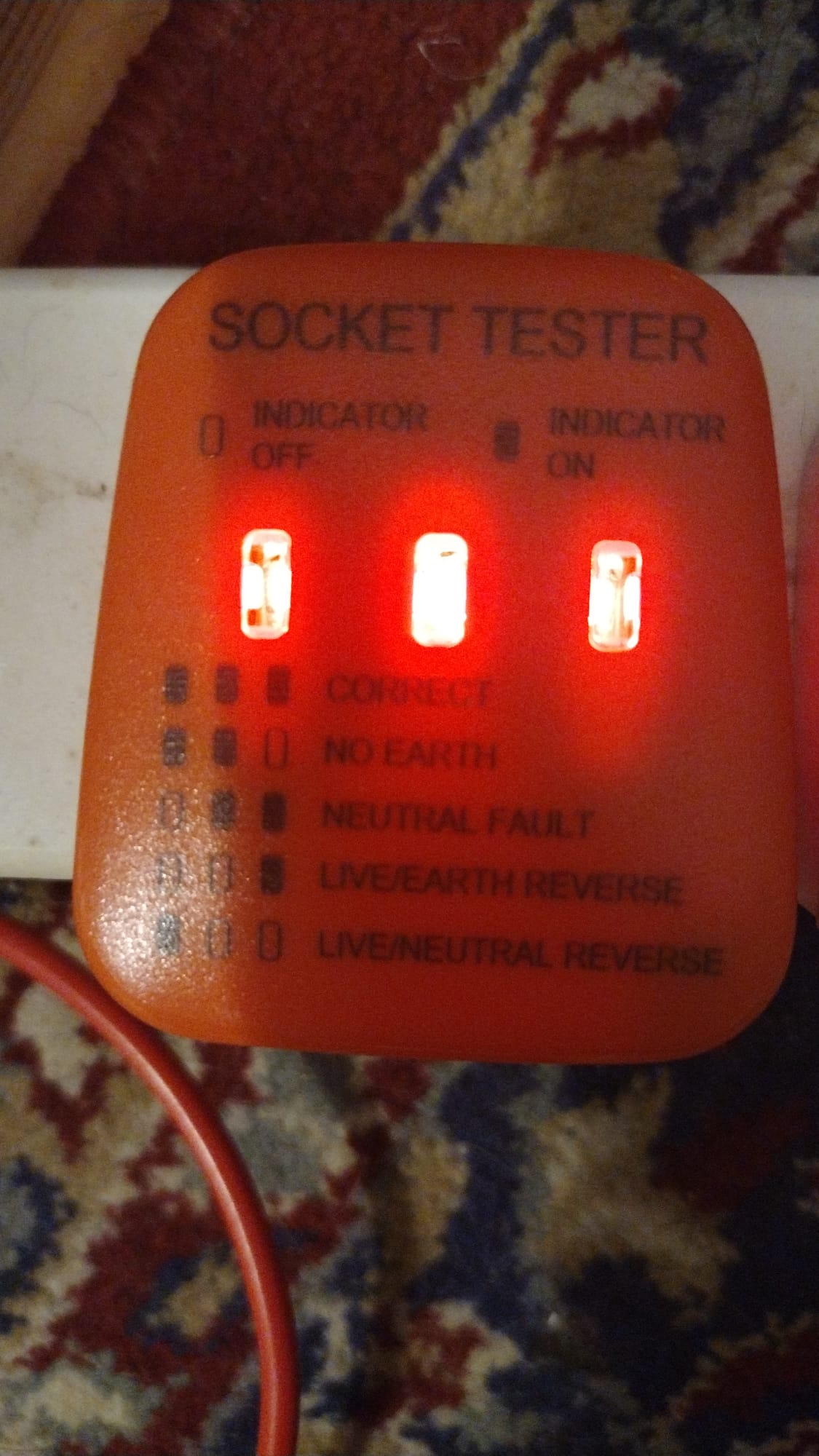

I have this orange plug that I stuff in the socket after connecting ehu. So far it always shows no negative.
What exactly does the fault label say? 'No N', maybe, meaning missing Neutral?
Does this tester work correctly when you put it in a normal house socket that you know is OK?
This is is about 3 minutes ago in my house. The three lights mean it's working as expected. I have never seen it do anything else. I take it with me everywhere.
I thought you meant it showed a fault, not that there were no faults. I also have one of those, use it frequently. If you also have one of these, you can use the socket tester on the hookup post and the hookup cable:
