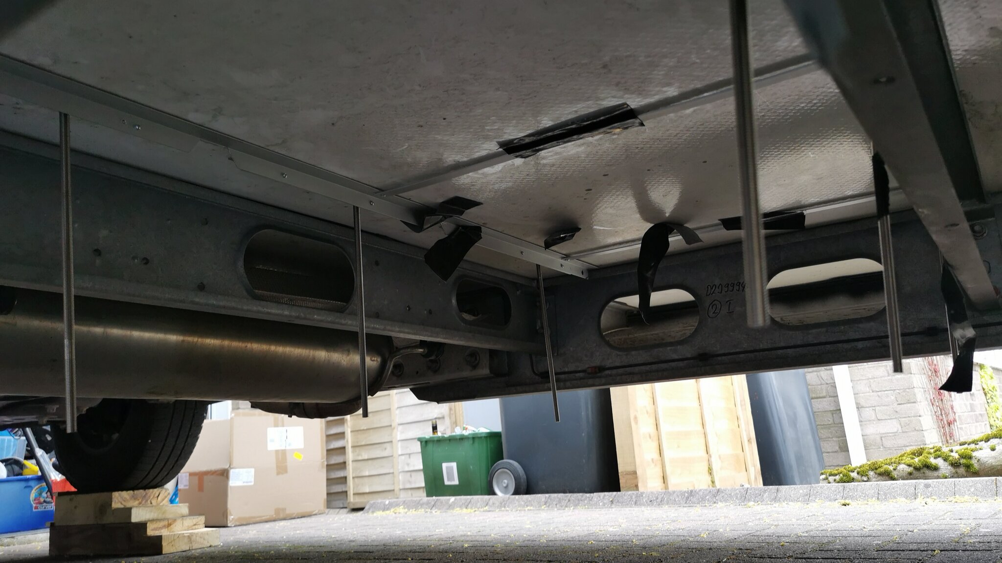

Insulated the tank and built mounting frames to support it and bolt through the floor
