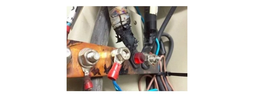

electrical tape used like that is asking for issues in the long term. I would swap that for heatshrink or proper Tesa 51608 tapeView attachment 954119Rather than have a mess of wires coming off the positive terminal, a neater solution is one of these. One main fuse, then sub-fuses for hab load (only thing connected when I took the photo), solar, mains charger and B2B.
And yes, the wiring in my German van has a black wire for positive (negative is brown). And I've confused things by using red and black.![]()
