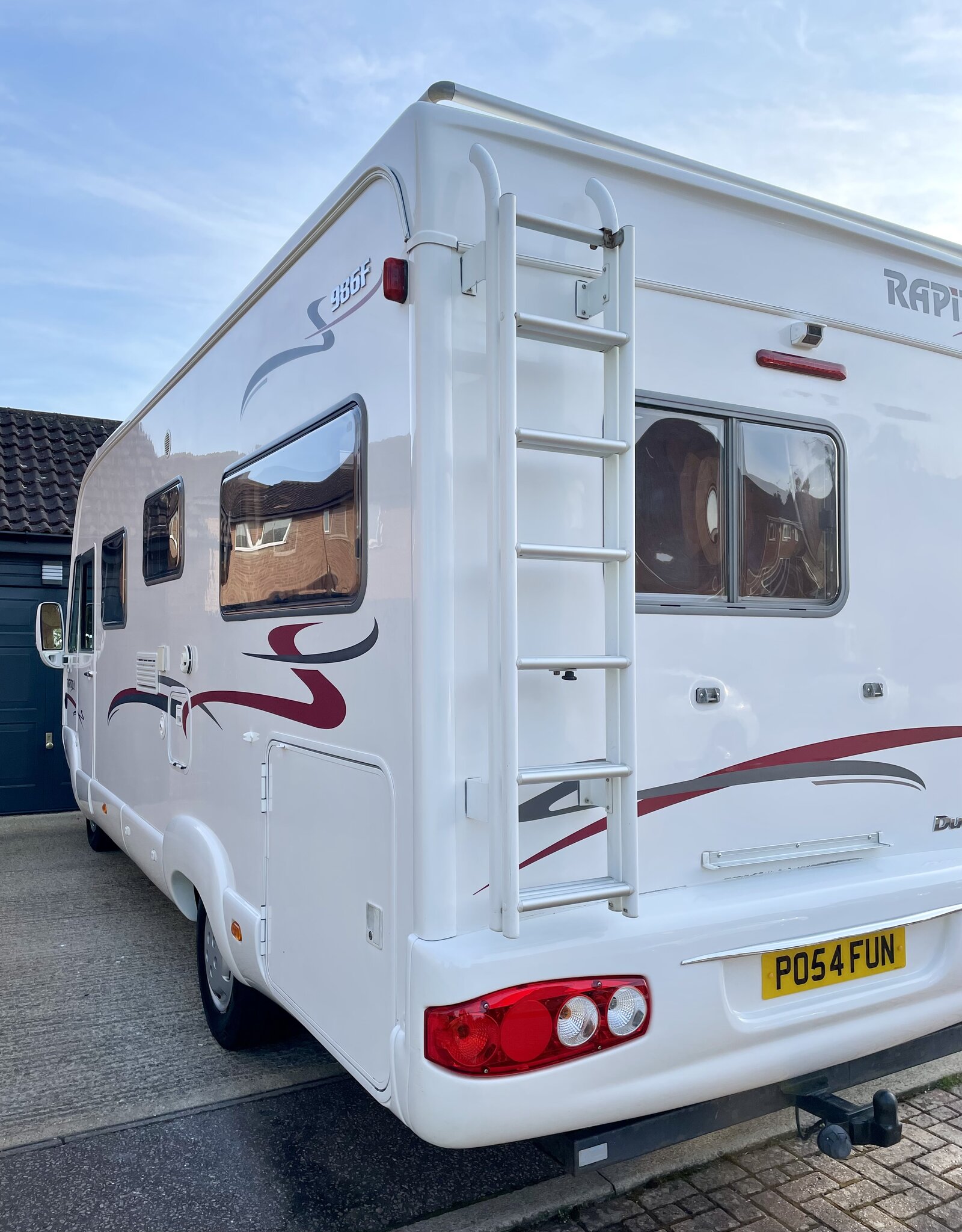

Ours is a coachbuilt. What would I do with that, please?
Honestly, I have no idea what to do with polish / wax / shampoo with wax. I did buy some stuff called Pulicamper, that I used to clean black streaks off the back of the MH but it left it dull and then i didn't know what to do. The rest of it, apart from the roof, I just do with a bucket and sponge with water and a bit of washing up liquid. I have never cleaned the roof. In fact I don't even know what it loks like up there! And I'm super-scared to clean the solar panel in case I damage it!!! My husband cleaned the roof once, but I don't know what he used. I do know there was a LOT of water involved from the hose!! LOL
It's pretty grubby right now. If I wash it using the Pulicamper and rinse it, what do I do then, please? Also, can I use the Pulicamper on the roof (I have 2 Pan windows, 2 skylights and the solar panel up there)? Thanks :)

I’ve no idea what Pulicamper is I’m afraid I’m guessing it’s a proprietary cleaner for caravans etc.
Yes use it on the roof etc to get rid of the grime and any green stuff 👍
You then need to decide how deep you want to go with doing your van.
You’re van being a coach built will be fibreglass behind the cab, happy to be corrected.
The cab will be metal.

The Pulicamper was recommended by a few people on here a while ago for getting rid of black streaks and, I have to say, it really works.
I can't really go too mad with it because I (a) don't have the time and (b) I struggle with my energy levels. I'd just like it to look clean and a bit shiny :) Maybe I really need a valeter but I've never heard of one in France :confused:
