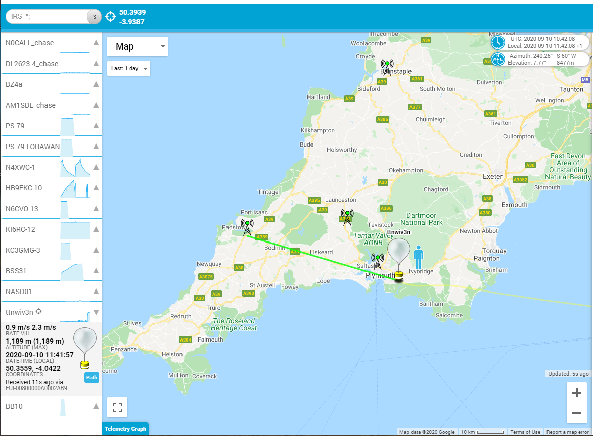

I described my faltering attempts to master Arduino programming and subsequently building a solar powered tracker to attach to a small(ish) balloon. After various mishaps and setbacks I am now in a position to attempt to launch the balloon tomorrow. The weather forecast suggests very low winds at ground level, which is essential for a balloon with only 3g of free lift - meaning it will rise slowly.
If I can get it to fly, the predicted flight path will look something like this:
I think only the first part of the flight can be reliably predicted so I am expecting it to cross the Channel and enter France then probably fly south. Where it goes after that depends to quite a large extent on what altitude it reaches. Anything over 7,000m will be good and 8,000m very good.
The biggest unknown is whether the radio will work once aloft. It is solar powered and therefore needs to get above the clouds, which it should, but its signals will have to be picked up by the network of TTN gateways spread around Europe. There are a lot of gateways but not many have antenna mounted outside, the majority are indoors which isn't much help.
But the only way to find out is to launch and see what happens.
I'll report back once it has been launched with any progress reports. If any progress is made of course! :)

Wow so higher than you were hoping for?
Yes, for a single 50p balloon it has done very well and now levelled off at around 8,900m. :) The pressure in the balloon is probably around 0.3 to 0.4 psi but it has been tested to 0.6 and was held above 0.5 for 24 hours so it should last a bit longer.
Sadly I think we will lose contact with it soon as the sun goes down, which means, assuming it stays afloat a bit longer, it will probably make landfall in the night which I would have liked to have seen. The mission only had two objectives:
To get aloft and communicate with gateways at long range - tick
Cross the Channel - not yet ticked.
Anything beyond that is a bonus. :)
It will be awaiting game to see if it wakes up with tomorrow's sun and lets us know where it is.
