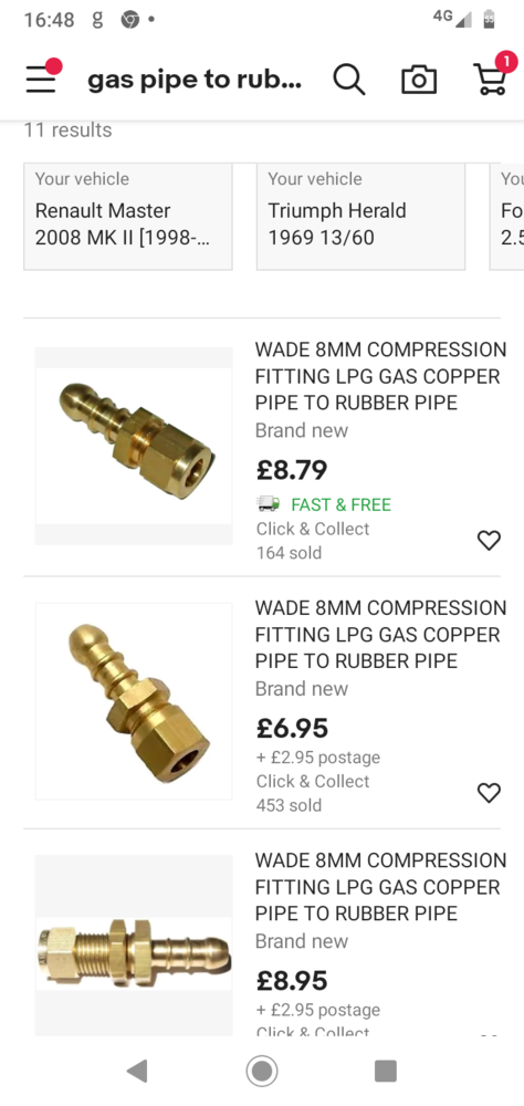

Not best practice admittedly but has worked without problem many times, or use one of these that I mentioned in #59
or
I have used these to easily change over different bottle top regulators

Although not asking me here you go
Although not asking me here you goView attachment 402513
The problem with using those is you would have to remove the existing connector & cut the pipe down to get rid of the existing olive, not ideal when you come to fit a replacement regulator.
Much easier to carry the proper hose that just screws onto the existing connector.
