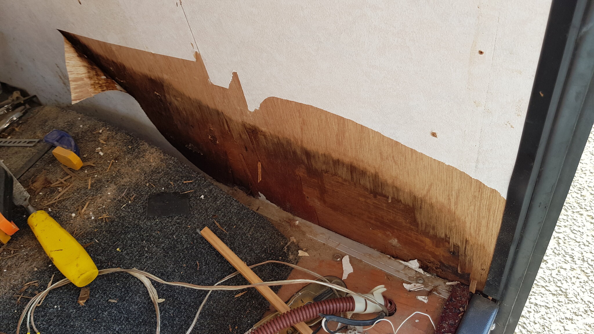

I decided to give the near side wall some scrutiny, even worse than the off side. I trimmed the plywood that was damp and stained. Cutting back the polystyrene, there is a wooden beam at floor level and this is rotten and will need to come out. The offside one was just wet and slighty spongy, so treated with wood hardener.
There are no obvious signs of water penetration from the window or door. There is a seam on the outside at this level and wonder if the seal is not complete, allowing water in?

Todays little job, it was totally unplanned. It has gone reasonably well. I thought it would be like the other side but how wrong was I.
Trying to dismantle the wooden batten it really was like a swimming pool.
The alloy cap on the outside involved partly removing the fibreglass skirt and the dooframe to gain access to the screws.
I was then able to remove the rotten wood.
The outer skin does not meet or overlap a bracket that supports the batten allowing water that has penetrated through faulty fitting seal. This allows the batten to sit in a puddle of water, never able to dry out because of vinyl coverings.
The faulty seal allowing water to penetrate.
Digging rotten wood out of channel to assess how it was put together, so I could take it apart.
The batten was rotten from the back almost to the door. I will replace all of it.
Dropping the skirt down to gain access to screws to undo the aluminium capping. The back of the motorhome is over the pavement, so the jack was needed to raise body a couple of inches, to allow easier access to undo skirt screws. No danger.
The sidewall is released from the floor allowing easier removal of rotten batten.
Finish cleaning the sidewall and the channel so it can be gloss painted so I can use Tannalised wooden batten.
I will have to take the doorframe out to assess the damage, some screws were only held in by mastic.
