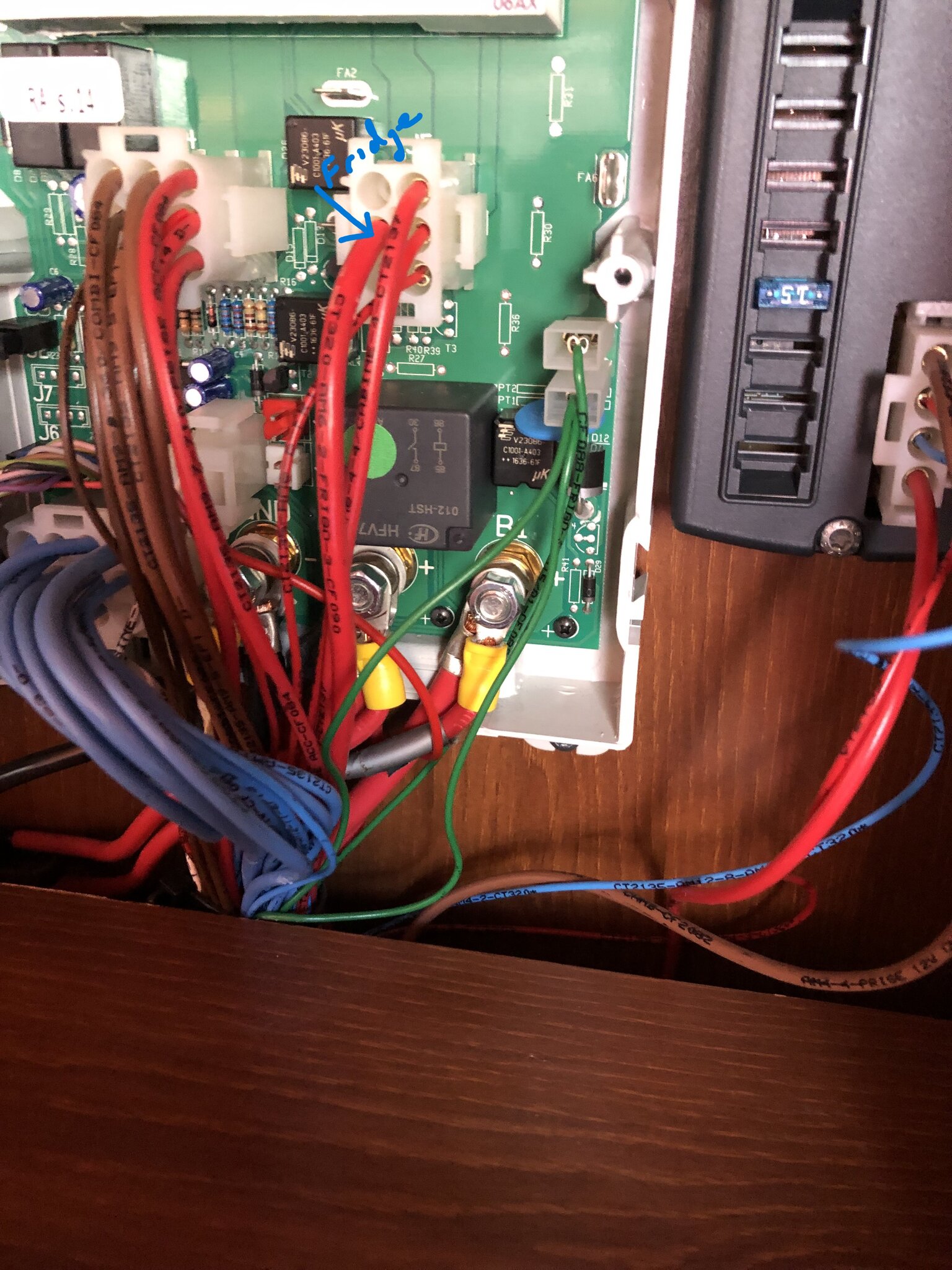

Good morning nickq,In my van I believe the DS300 supplies power to the fridge from pin 2 on connector 17.
Annoyingly it is just about impossible to trace the wires after they dissapear down that gap. I would have to remove most of the woodwork and possibly one of the 2 fresh water tanks (it's a split tank setup).
The top wire on B1 with the silver tape is the solar feed for the starter battery. The regulator (NDS320) is just to the left. The top wire on B2 is the solar feed for services battery.
The wire that appears at the services battery is 8.5mmsq. I'm guestimating this is no more than 5m away so this should be good for 30A (2.36% drop).
I do have R37 so intend of snipping this to disable the split charge relay and installing the B2B.
I believe the 2 relays (V23086) next to connector 17 are the AES bridge, which the manual states connects the fridge directly to B2. So I guess this is your point of the fridge being supplied by B2 as when the split charge relay is disabled, B2 is no longer in parallel with B1 and is only supplied by the B2B.
The green wires are the simulated D+ so I should be able to use this to trigger the B2B.
So for these reasons I need to situate the B2B by the DS300, there will be no D+ near to the services battery, also this will prevent the current to power the fridge from travelling the cable from the services battery. I am not bothered about fast charging from the alternator, but powering the fridge adequately is of course required. My fridge is the Thetford N3000 Model B which I believe can draw up to 15A.
So in summary I think the 30A B2B installed by connecting input to B1 and output to B2 of the DS300 and removing R37 to disable split charge should be good. Up to 15A could go to the fridge from the DS300 directly fed from the B2B->B2 leaving 15A possible to charge the services battery via B2. Curious that they fit a 30A fuse for the fridge, seems a bit large to me.
Does this make sense?
