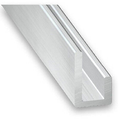

First mod was the step well mat as I found out the hard way nothing holds it in place, first time in the van at the dealers as I got out I went flying out the door, flipping dangerous.
A length of unequal channel alloy sorted that, unequal channel as then I could fit it using the original screws for the foot well.

Where you get the channel from please, our mat stops the fly curtain shutting.
