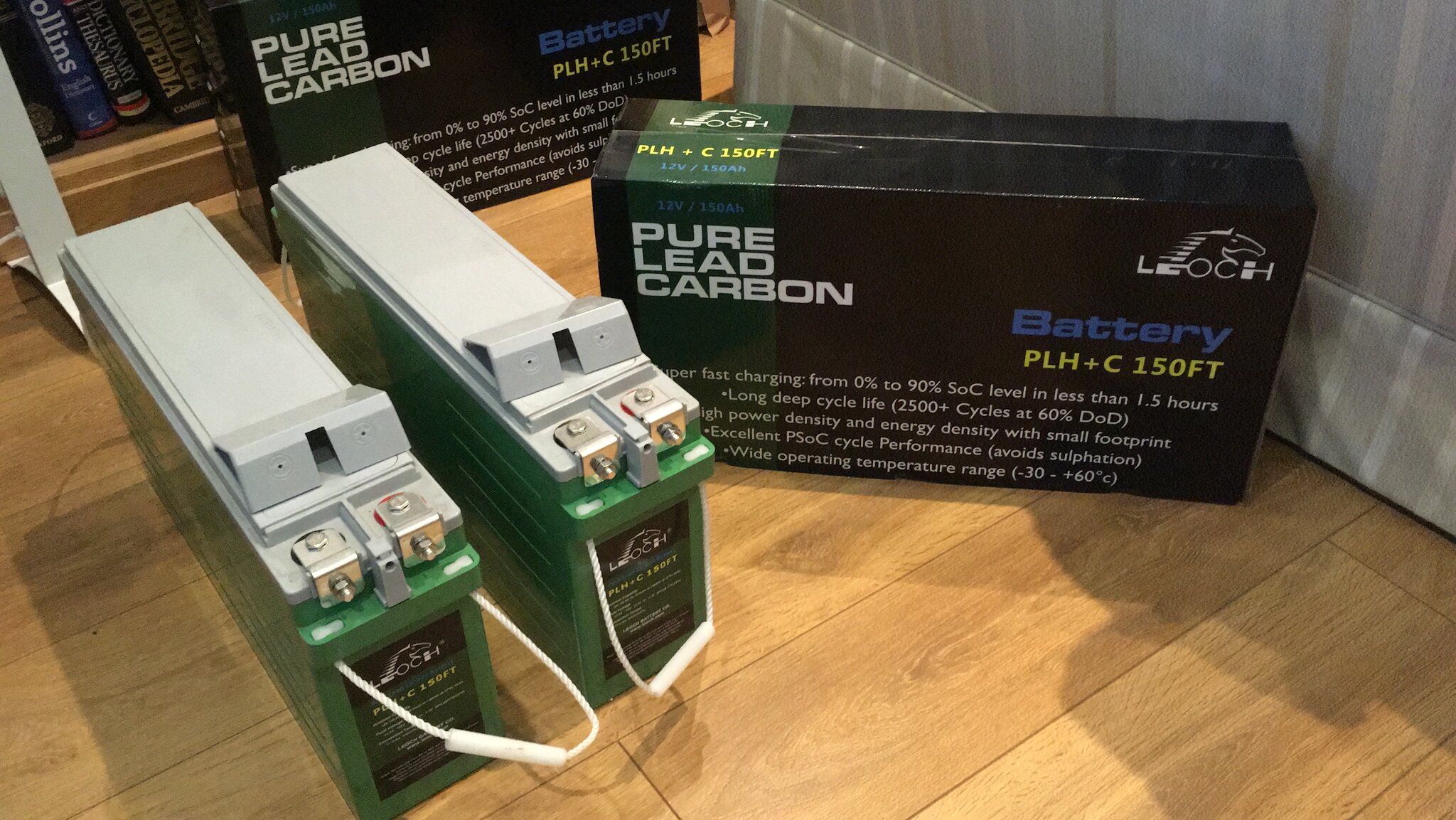

Ordered a pair of 150ah Leoch PLH+C lead carbons yesterday. Got over £130 off by price matching between Kuranda and Alpha Batteries so looking forward to seeing how they perform.
remember you might need posts unless you already have some, I persuaded Alpha to throw me 6 in (2 spares) as my mate had one split on him.
150ah ones will be bloody heavy so i hope your young and fit 😉👍
keep us posted as to what you think of them
Yeah 50kg each. It’s John at Alpha that dropped the price by £65 each so thought that might be a bit cheeky. I have hydraulic crimpers from when I made up my first leads for years ago so hopefully will just make up new leads and terminals to match.
I have the height for the 210ah ones but would only leave me 200kgs of payload n the B2B chargers only 50amp so prob bit of an overkill.
So it's a cost of the battery plus one year of gym membership prior to installing? :smiley:
