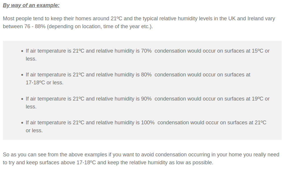

The condensation threshold is where the relative humidity (RH) of the air reaches 100%. At this point, the air is cooled to the point where it can no longer hold the moisture, causing it to condense into a liquid.
Condensation occurs when warm, moist air meets a cold surface, such as a window, door, or threshold. To prevent condensation, the inside surface temperature of these areas should be higher than the dew point.
The dew point (or condensation threshold) is where relative humidity would exceed 100%. Warm air can carry more water, but if it cools near a cold window some of the water may condensate out. So either make sure the window isn't colder than the interior, or reduce the amount of moisture in the air in the interior (typically by airing it out). Probably a bit of both.
