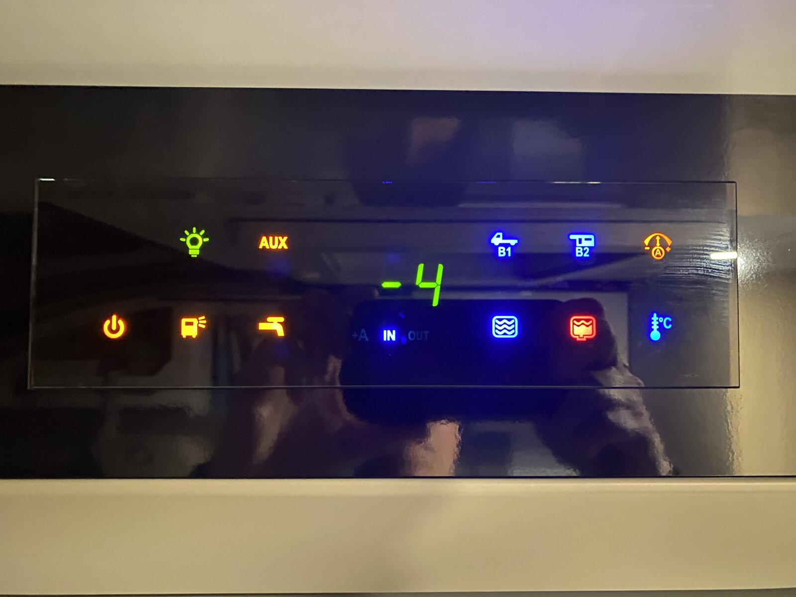

We have owned a touring caravan, two static caravans and three motorhomes over a period of 20 years.
We have never heated any of them when not in use over the winter and never had any condensation or damp.
This photo was taken a few years ago.
It was the temperature INSIDE our motorhome during a cold snap and we still didn't have any problems.
