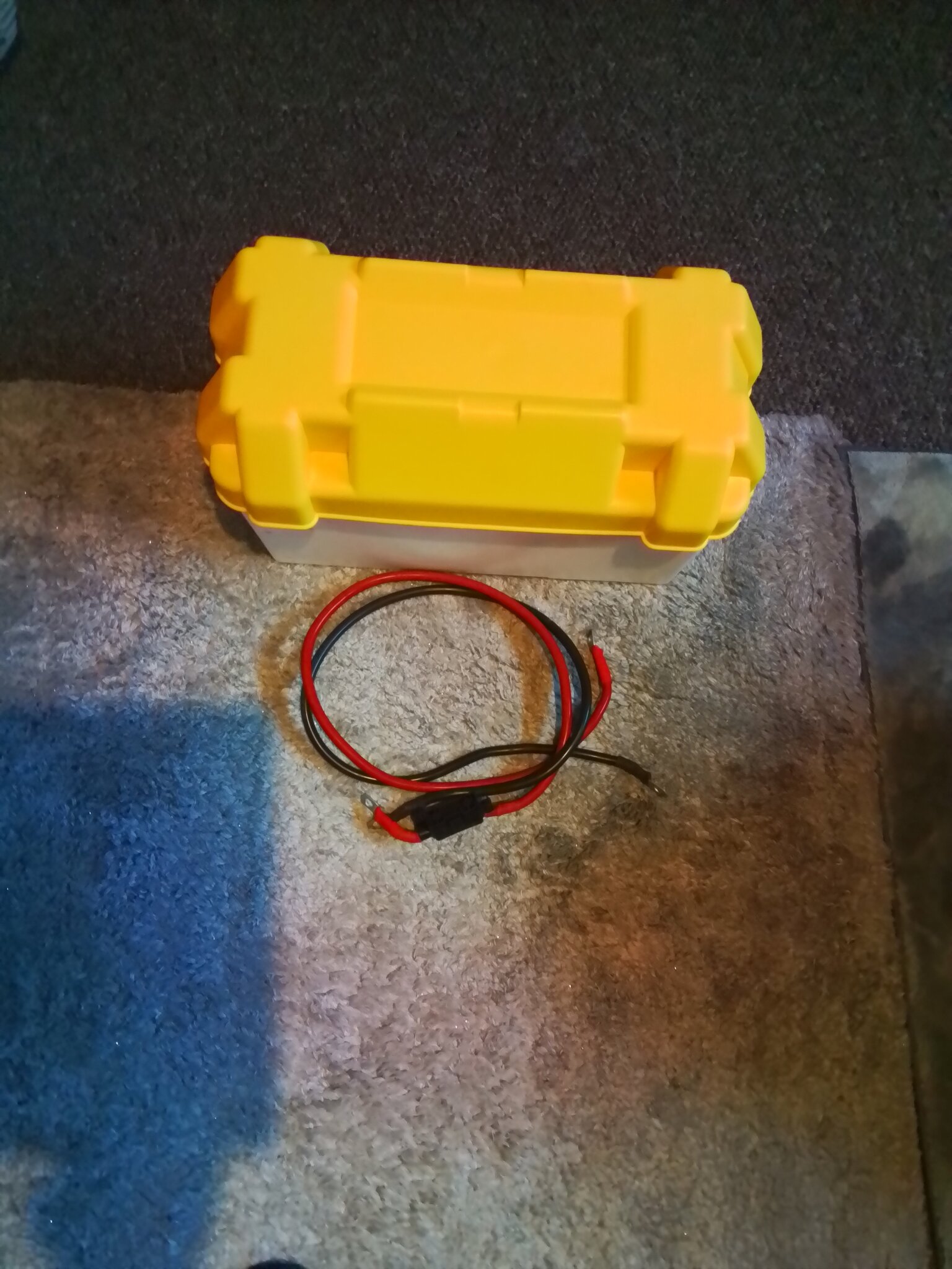

Just an FYI I fitted a bigger inverter to my motorhome this week and a second leisure battery and inverter to my sisters motorhome 2 weeks ago.
I bought ready made cables, for £6.50 each, as my crimping tools are not really up to crimping 240 amp 35mm2 cables.

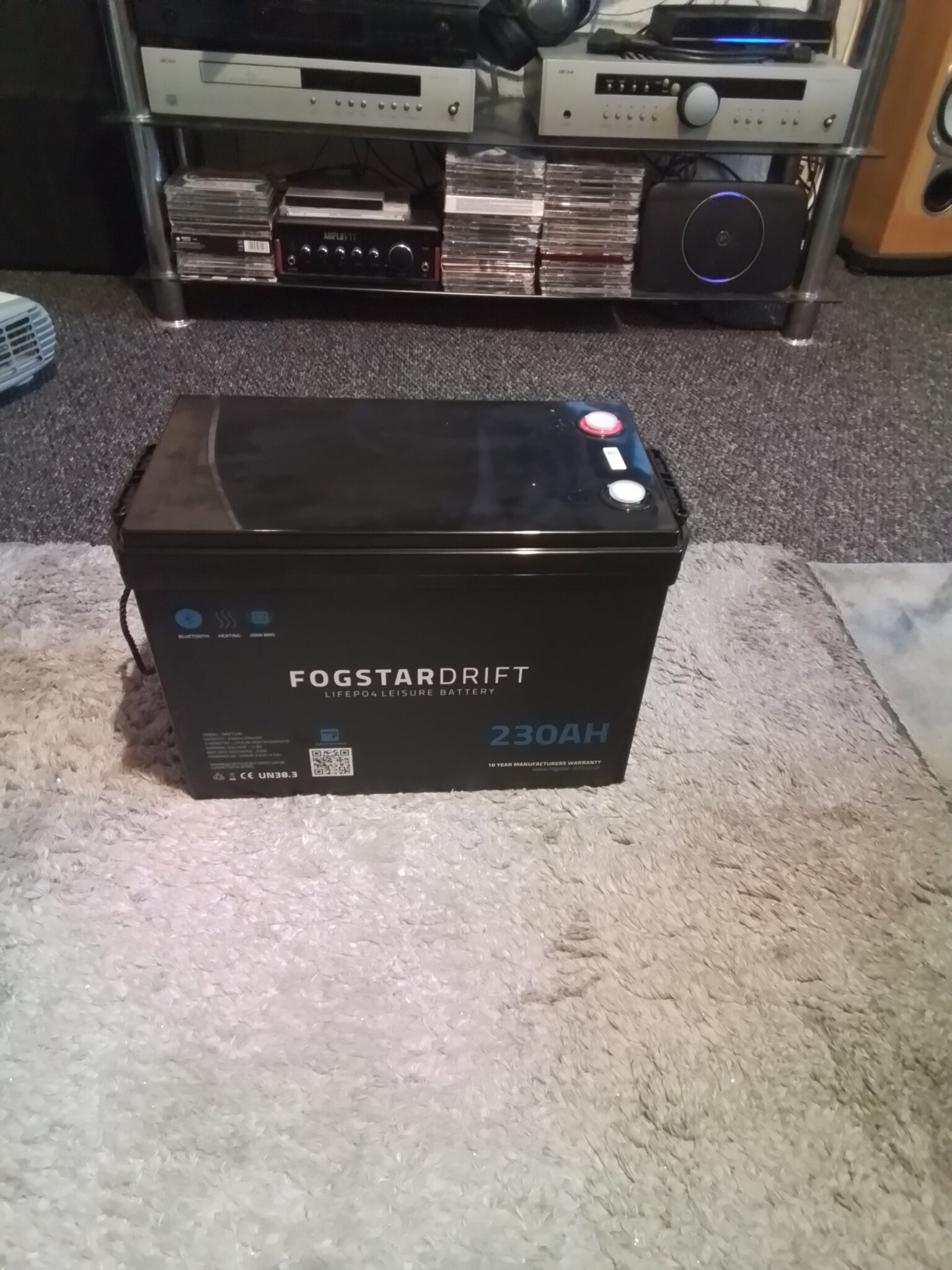

FYI I recently replaced 2 x 100AH lead acid batteries with a 230AH Fogstar Drift LifePo4.
The Fogstar fitted in the same plastic battery box that 1 lead acid was in.
The 230AH Fogstar is rated to power a 2500 watt inverter so would be fine running your inverter at max.
Also the wiring is easier with a single battery set up.
offagen
That's the same type of battery box that the present 2nd leisure battery is in and is close to the inverter. The downside is that the various cables running from the 1st battery to the Sargent panel would need to be replaced or extended. No big deal as the Sargent is right behind the inverter.
If the new battery could fit in the original below-floor battery box the yellow battery box could be removed to free up locker space, and also perhaps avoid having to replace/extend existing cables, but I'm doubtful that a 230Ah lithium would fit. Perhaps, also, a below-floor installation may not suit cold weather charging?
None of these issues seem insurmountable. It's probably best to take advice from whoever does the remedial work and can see where everything is.
Thanks again for your input.
Edit: The below-floor battery box measures 395x193x255h so the Fogstar 230Ah would not quite fit. However, a KS Energy 155Ah would fit, so maybe a possibility?? We'll see.....
