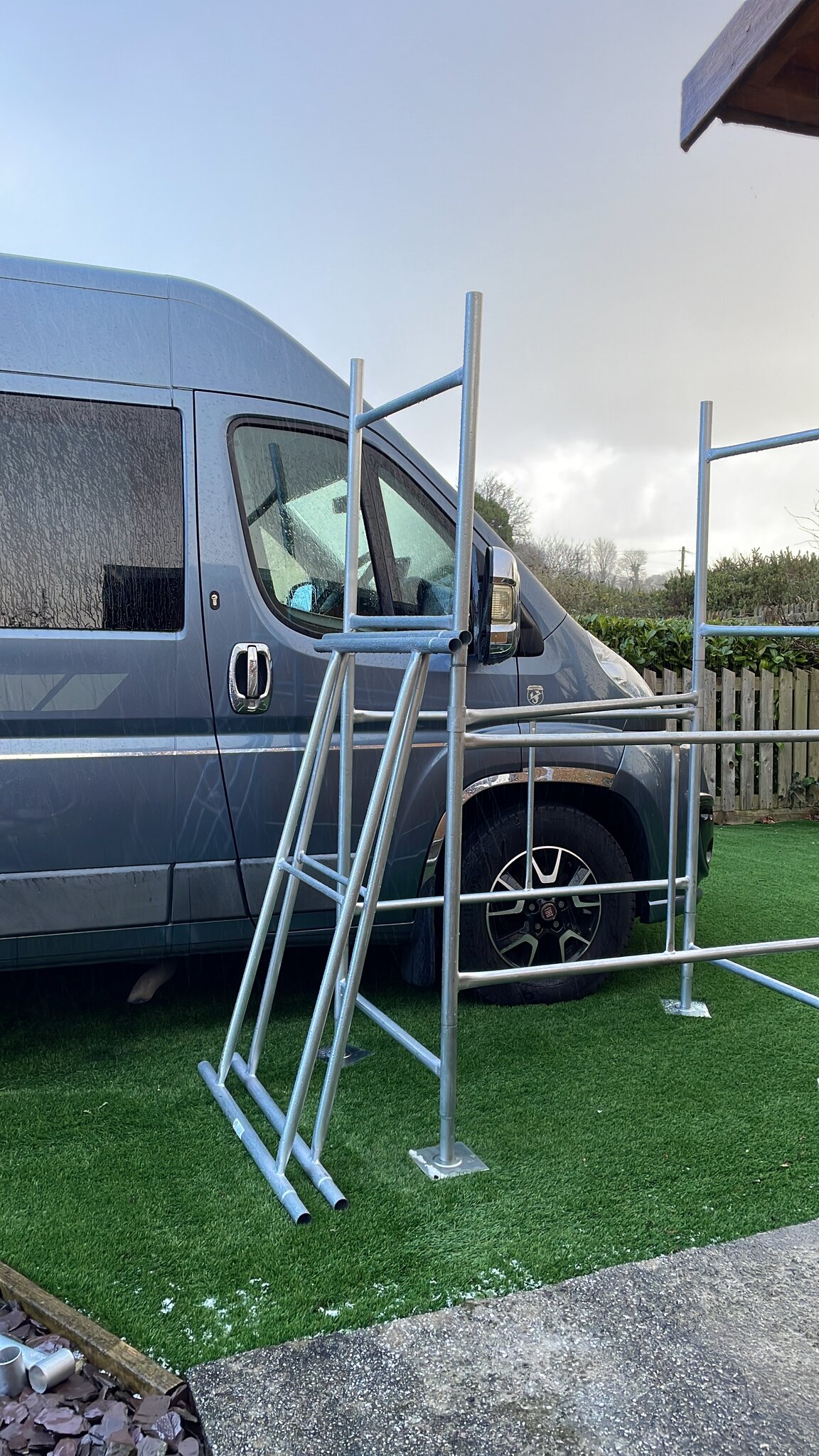

However... you still haven't answered my question. How the feck did you put the scaffolding up. Curious minds are seriously impressed and incredibly nosey :p :D
I don’t understand why your apologising Karl… Gromett
It came in sections and you just build it up as you go up…
I used to use a ladder but got the scaffolding as I knew I would use it a lot and it would be safer…
On an older van I had I could get up the ladder and through the sky light but on this van there too small..😎
