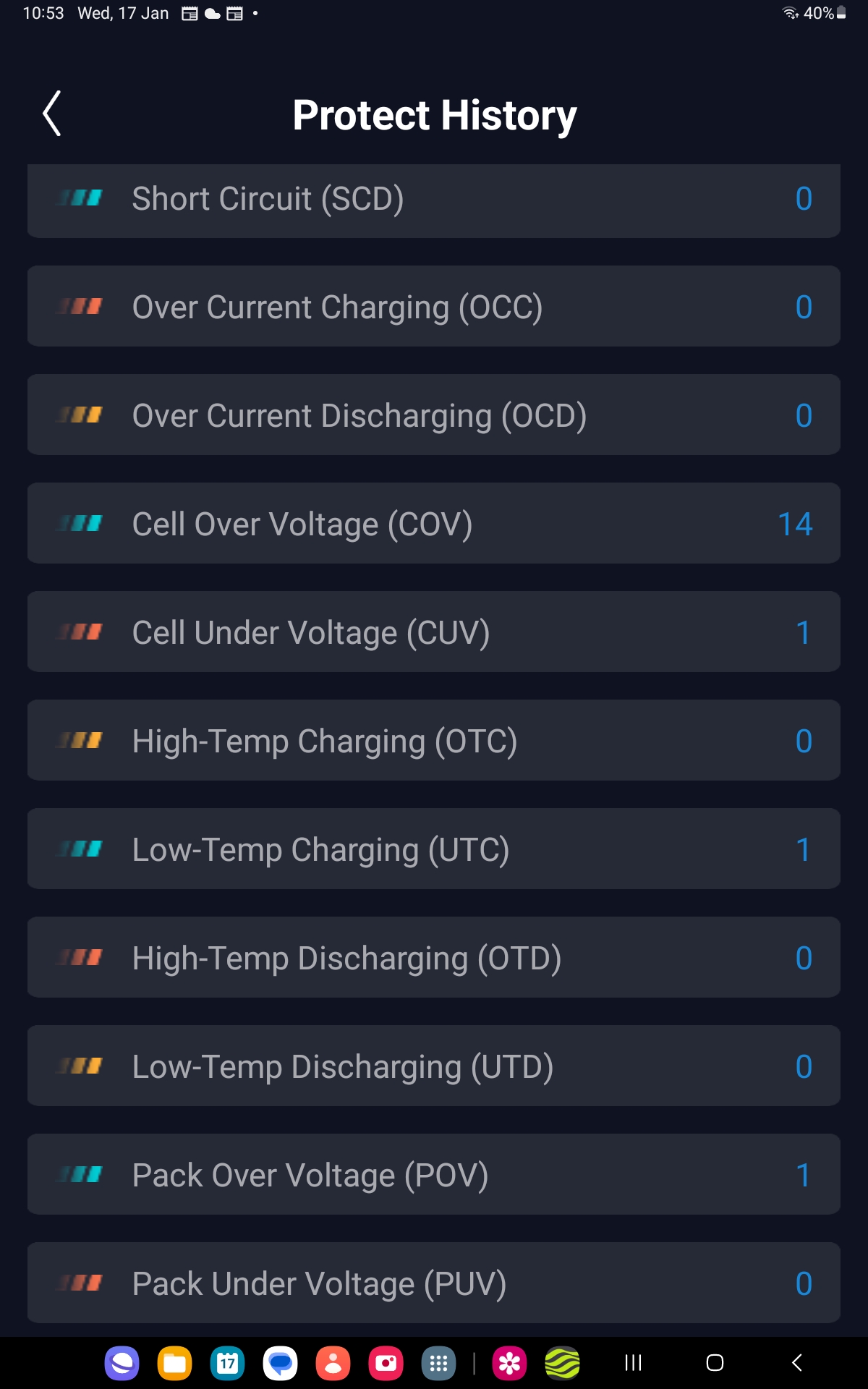

I have found this in the battery protection history in the app.
BATTERY 1
BATTERY 2
So battery 1 has had 14 cell over voltages, 1 cell under voltage and 1 pack over voltage.
Battery 2 has had 5 cell over voltages and 1 cell under voltage.
Batteries are in parallel, charging sources are Fogstar 20 amp lithium charger, 14.4v charge and Victron MPPT and Sterling B2B both set to lithium 14.2v charge 13.5v float as per instructions.
Sounds like one of your chargers is not performing to spec if the BMS reporting is correct.
Check your voltages as you turn the various charging sources on and off. My voltage surge happened when I stopped the engine.
BATTERY 1
BATTERY 2
Do you have a Victron shunt with a temperature sensor networked to the Victron MPPT? I'm just wondering if the cold weather is increasing the voltage from the MPPT causing the issue?
BATTERY 1
BATTERY 2
It means it activated the cell over voltage protection, not necessarily has been over voltage. And yes, your terminal charging voltage is to high if it triggered the pack voltage as well.

Had something similar on mine when I first set it up! Not had anything since I cleared the history 6 months ago!
I did wonder if they were just something left over from the initial build set up.
Now I am trying to get get my head out of the bloody app and just get on with living 🤯, just waiting for the bms to go down below freezing so I can see the heater mats work!! 🥶
On initial first charge at home using Fogstars charger the app reported 14.7v, even though the charger only charges at 14.4v. I immediately turned the charger off.
After half an hour the app was reporting 13.4v so I turned the charger back on and it charged to 100% fine.
This happened with one battery only.
Can you explain what you mean please ?
I have never seen cell voltages above 3.55v on either battery.
The only time I saw high pack voltage was on the initial charge at home on one battery and although the app showed 14.7v my multimeter showed 14.4v when the charger was on and 13.4v when it was off.
