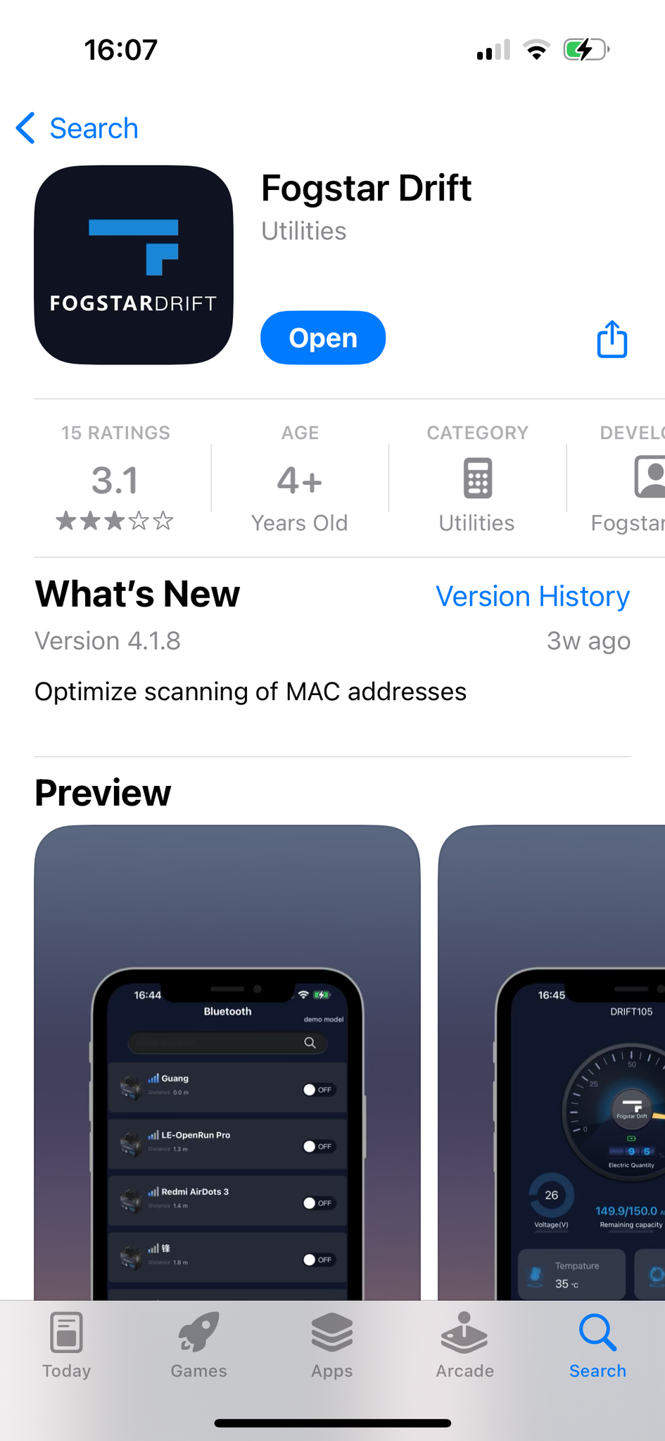

I’ve not paid for the Fogstar Drift app
it’s free from the app store if you buy the batteries or not and 1 app sees both batteries
Is this the new app as my apps only see I battery each but Fogstar told me there was a new app on the way and it would see 2 batteries in parallel as 1 battery.
No it’s the original drift app i’ve had about 6 months
