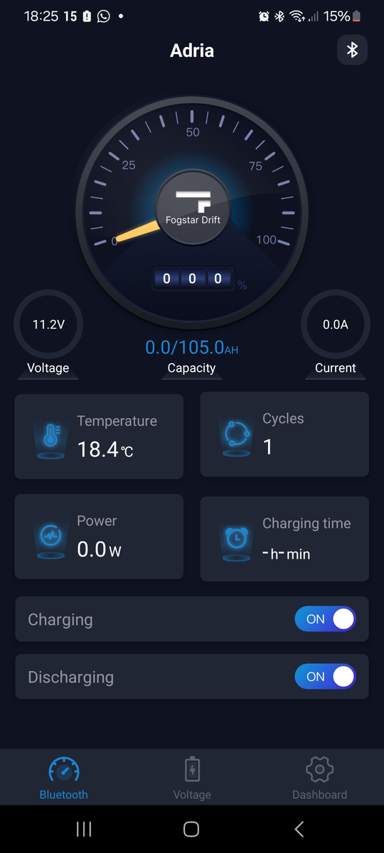

What do you mean by the "app has continued not to work" ?
You have posted screen shots of the app so the app itself must be working

This is the app currently. 0 on capacity, 0 current, 11.2v, I believe all are incorrect.
This morning with 0.0 capacity we had lights, heating and could raise the electric bed.
This morning with 0.0 capacity we had lights, heating and could raise the electric bed. View attachment 983227

That 11.2v is dangerously low with loads. For reference divided by 4 cells = 2.8v per cell. You should never need to go below 3v per cell, (12) from here is less than 5% capacity left. Spend a couple of days on ehu, and give that battery time to absorb. It looks like you are working in heavy deficit and weak means of charging.

Try uninstall and reboot phone the install again.
Morning all. Well, latest bit of the saga, this morning the vehicle battery was low and I've had to jump start the vehicle. I think it's suffice to say that my vehicle electrics are completely up the shute and there is something very wrong somewhere. We're cutting our stay short and going home, I've got the van booked in with my electrician tomorrow.
The app is showing the Fogstar battery is charging from the engine, so maybe the app is OK. Something completely depleted the Fogstar on our first night, and after that it hasn't charged from either solar or the mains.
