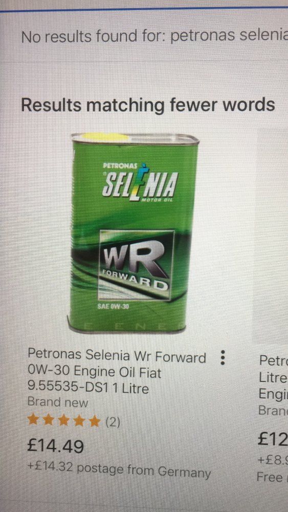

Regarding the oil, I bought this off eBay for top up, now it seems you can only get it from Germany. I can’t see any of them using this for a oil change.
