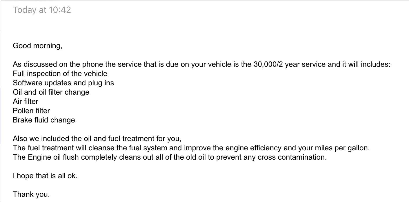

Someone told me to ask for the breakdown of the service, this is it.

But as your mileage is less than the average expected mileage that the normal service schedule is designed for, you can get away with a low mileage service. You need to ask for it and get a quote.
Oil and filter change is important and in fact for lower mileages would benefit from being done annually.
Unless you've been using your van in very dusty conditions you almost certainly won't need an air filter. You can check it yourself before taking the van for a service. Even if it looks a bit dirty on the side nearest the intake port in the filter box, it may at the worst need a quick vacuum with a soft brush attachment, or if not just turn it so that a clean section of the filter faces the intake.
Cabin air filter should also be good for at least 4 years, again unless you've been motirhoming around the Sahara.
Brake fluid unlikely to need changing at 2 years but you could ask for a moisture reading before deciding.
Engine flush is not required and just a money making exercise on the part of the dealer. In fact, unless you haven't run the engine or changed the oil for a much longer period than the age of your van I would say an oil flush is to be avoided at all costs, and even then it's benefit Vs risk would be dubious.
Fuel treatment ditto.

@Mickey1 I agree with what @Deneb said. And in fact that is what D Salmon told me, low mileage (circa 11k for ours) does not need all the above only oil & filter and general safety check, even at 4 years you are unlikely to have covered the 40k miles that a commercial vehicle would have done...

@Mickey1 your warranty will run out at 2 years so no need to worry unless you have some problems needing sorting out. Try again for low mileage service explain your situation and advice given here. And another way to look at it is an hours drive each way equals 2 hours @£70 an hour......
But you can still tell them not to carry out procedures or replacements that you don't want, and not to bill you for them. Oil flushes and fuel treatments are not required by the vehicle manufacturer and in fact some explicitly state they should not be used.
