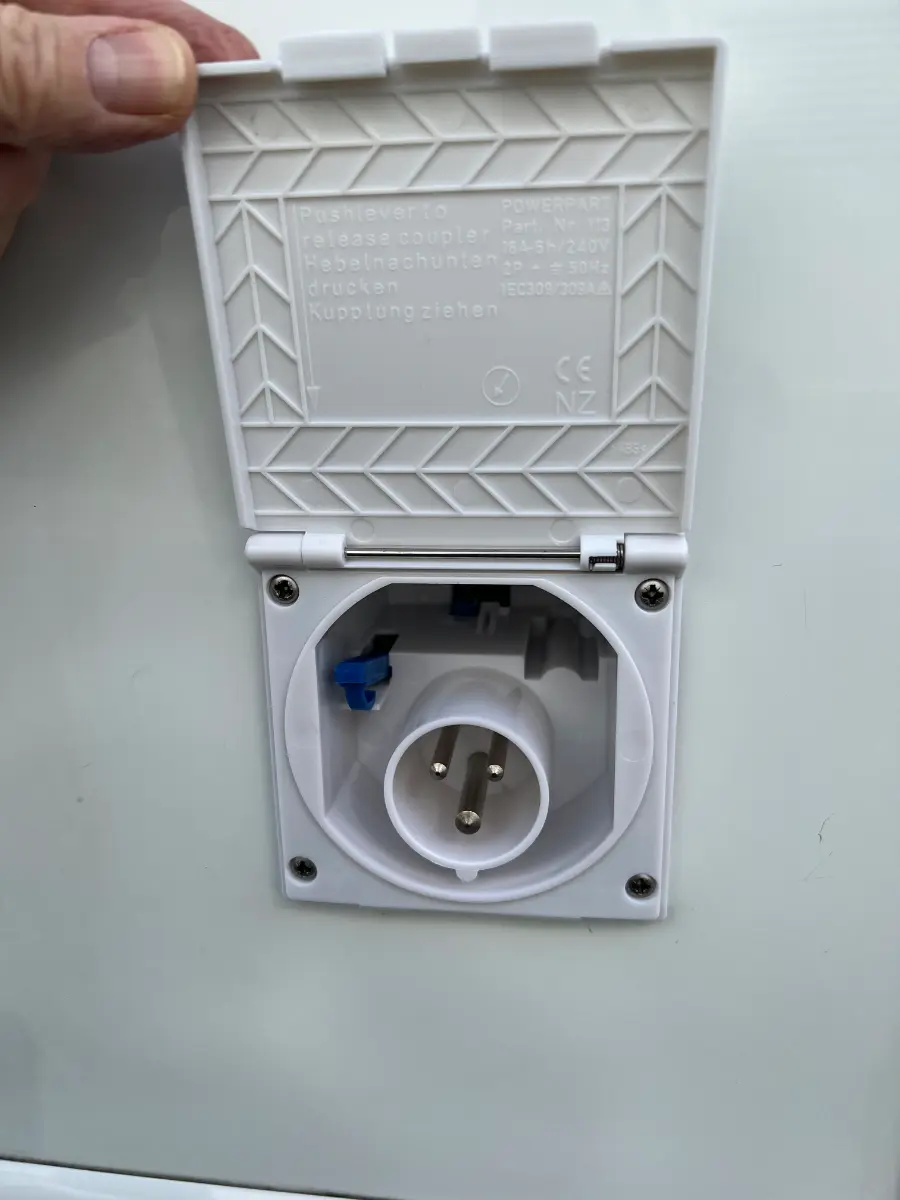

A connector can be 'panel-mount' or 'in-line'. So the van end of the EHU cable has an inline socket, which mates with a panel-mount plug fixed to the van. At the other end of the EHU cable is an inline plug, which plugs into a panel-mount socket.

The hardest bit was carefully removing the old one as they are fitted tight . I ran a Stanley knife slowly around the old one and carefully levered it out using a large flat board screw driver - the rest was simple even for me
The flag you mention I presume is the "flap" that covers the "plug" fitted to the motorhome . Depending on the make you may be able buy the "flap " seperately. Mine was on a Dethleffs Magic. I ordered the flap from Reliance in Chichester . enquiries@reliancecms.uk Chris is excellent at sourcing accessories for all manufacturers . It will save you removing the "plug socket " from the motorhome if this is the case. To clarify the socket on your motorhome is a flush male socket and the blue EHU lead has a female socket . Trust this helps .
I think it's correctly termed a bulkhead or panel male 16a Ceeform. In theatres the bit on the cable that fits into the bulkhead male is a 'flying female' but is more commonly known as a free socket or free female.
That said these things have various names Ceeform, Commando, plug,, male, socket, female, free, in-line, floating, bulkhead, panel, fixed, static etc. just make sure you get the right one.
