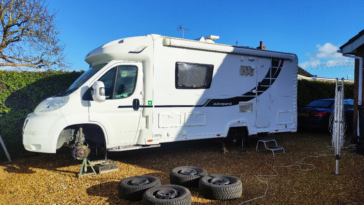

The E & P levelling system does come in very handy when you want to change your brake pads and discs all round. (y) :giggle:
And when fitting new shock absorbers 👍🏻
Unless someone at the factory installation of the 2 x rear shocks, fitted 3 of the bolts the right way round, but 1 x bolt the wrong way round, thereby denying access to the bleddy nut...........without further major work needing to be carried out.
Jock. :cry:
Jock. :cry:
I'm glad I only changed the front ones Jock (y) that's not why I didn't do the rears though, honest :LOL:
