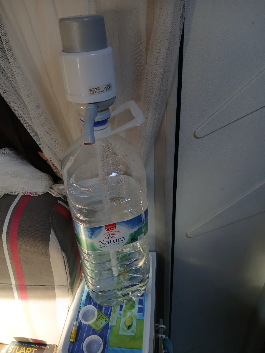

We use the 5 litre bottled water. And carry a plastic 10 litre jerrycan .
We can fit 2 x 5litre and x 1 x10 litre in our doorwell when travelling. Our main tank is used for washing etc. (y)
