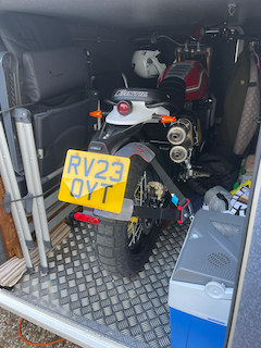

Carthago 141le (6.7m)
We have Fantic 500 scrambler (450cc) and fits perfectly. Dry weight is 136kg so added rear airbags.
Great bike as small enough to get in van but large enough for 2 adults
After using KTM 400 exc's (that I really loved) many years off roading the Fantic scrambler is not bad for a bit of 'rugged exploring' ...my wife just closes her eyes!
Ps. You can get a nifty 'in situ' piston type rear disc lock for it that's great for quick outside french café stops etc
