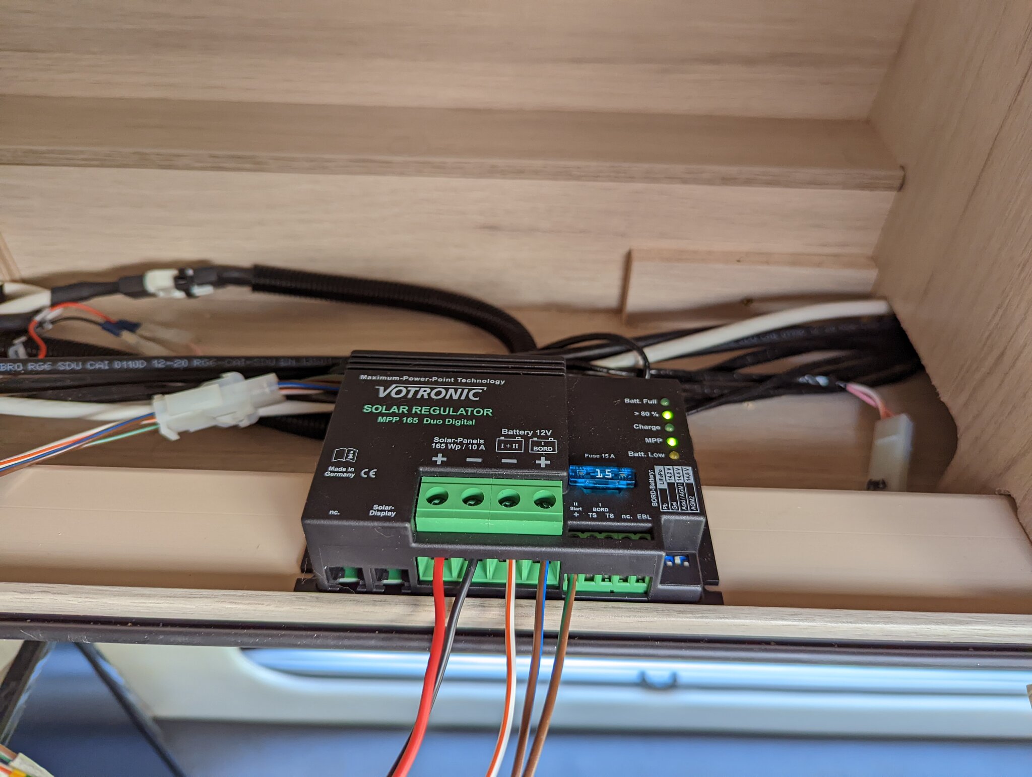

Anyway, my goal here was to replace the factory fit solar controller with one that would
- Charge both batteries at once
- Get more power from the panel using MPPT rather than PWM
- Have a charging profile that is good for keeping the batteries in good health
- Fit in the space occupied by the current charge controller and
- Is compatible with a lithium battery if we choose to upgrade in the future.
A good deal of research led to choosing the Votronic MPP 165 Duo Digital, which covers pretty much all my requirements and is from a well respected brand rather than some unknown Chinese brand. Just under £100 and quick delivery from 12V Planet - I bought a few meters of cable that I didn't end up needing to push the amount up enough to get free delivery. Note that at least one brand of dual battery MPPT charge controller (PV Logic) requires batteries with separate ground connections rather than the common ground used in almost all vans - this should be avoided as it will not work correctly in a van where the batteries have common grounds.

Now we get to the fun bit of connecting up the new kit - leisure battery first (orange/white to negative, brown and blue to positive) and also connect the vehicle battery to the start battery + terminal on the controller. At this point you can re-insert the 20A fuses to bring the 12V power back - the 'MPP' light should flash, which is the controller saying 'no power from the panels, ready to go when we get some'. Now connect the panel wiring - observing correct polarity, red to positive - and remove the cover from the solar panel - the controller should kick into life!
Excellent, now just to mount the controller properly and put things back together.
I used some electrical tape to bundle the cables and then fitted about 6 inches of mesh cable wrap I had handy from another project to give a tidy look.
Four small screws mounts the controller on the cupboard wall, nicely covering the hole left by the old changeover switch. It's best to put the cupboard floor back in place first to make sure you right the wiring to go straight up from the hole that was there for the old charge controller wiring. Make sure your screws are no more than 15-16mm to avoid going right through the end of the cupboard and possibly hitting a cable behind. You can then screw the cupboard floor back down and restore the screw cover stickers you saved earlier.
It all looks nice and tidy, with good space around the controller for ventilation even when the cupboard is in use. Note that this model (the 165) does not have a cooling fan - higher spec models in the same case do have a fan that apparently comes on when the controller gets hot.
Everything seems to be working as expected so far - a nice little mod to make the van that bit easier to use
