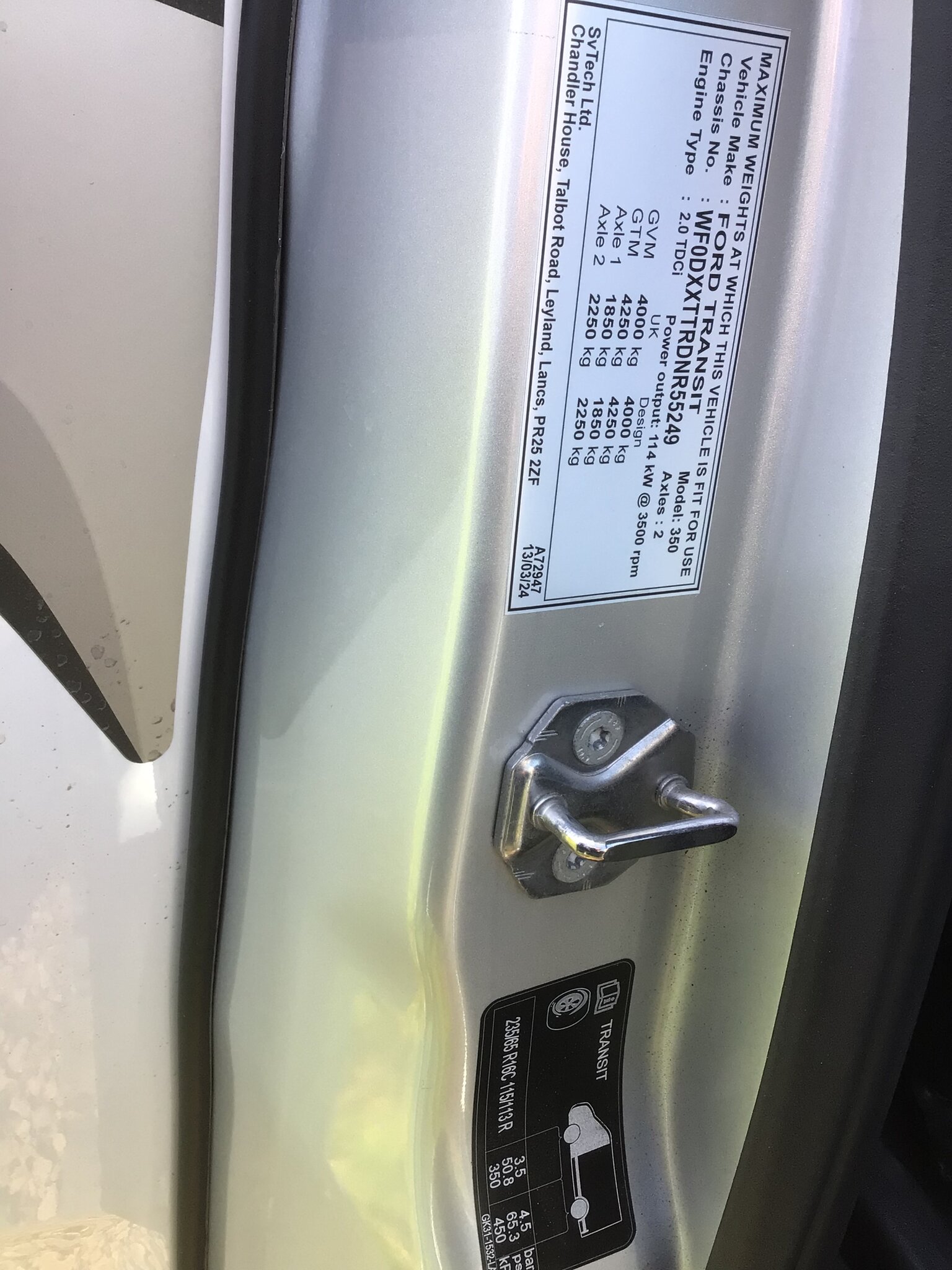

As Jonno1103 reports tyres are rated to 1200 (1215 on mine). I believe that I sent the tyre details to Sv Tech before they could confirm that no modifications were necessary in the up-plating to 4000kg. Thanks for the info about them providing another plate within a year for free if air assist is added. As I reported earlier my original motivation for adding airbags was to help with stability - and they have been great. I might as well now go for the full 4100kg if there is no additional cost. Thanks
Just waiting for my 4000kg plate from SvTech. It’s being printed apparently.
I stuck mine right next to the Ford plate on the door pillar. Be careful you only get one go at it. Now watch your rear axle loadings. The up-plating feels like you are getting a lot of extra capacity overall, but the rear axle on the Adamo is doing all the heavy lifting. I recommend airbags to improve stability on the rear - even if you don't need them for your up-plating.
Had to put in on the drivers pillar as there is another Ford sticker of some sort on the near side.

I have noticed 2 other posts on this link both have up plated to 4000kg one even shows the sticker from DVLA approving it. Just ring SV Tech they will confirm all this. The other 2 posts both used SV Tech

Yes. We have upplated despite our dealer saying we can’t. All done by SvTech.
Edit…see plates I posted.
